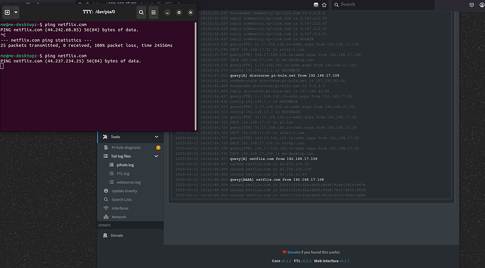

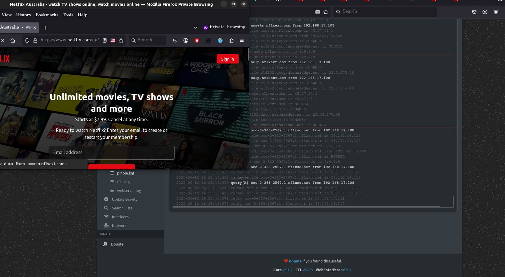

Now, PiHole is running but it is NOT blocking sites.

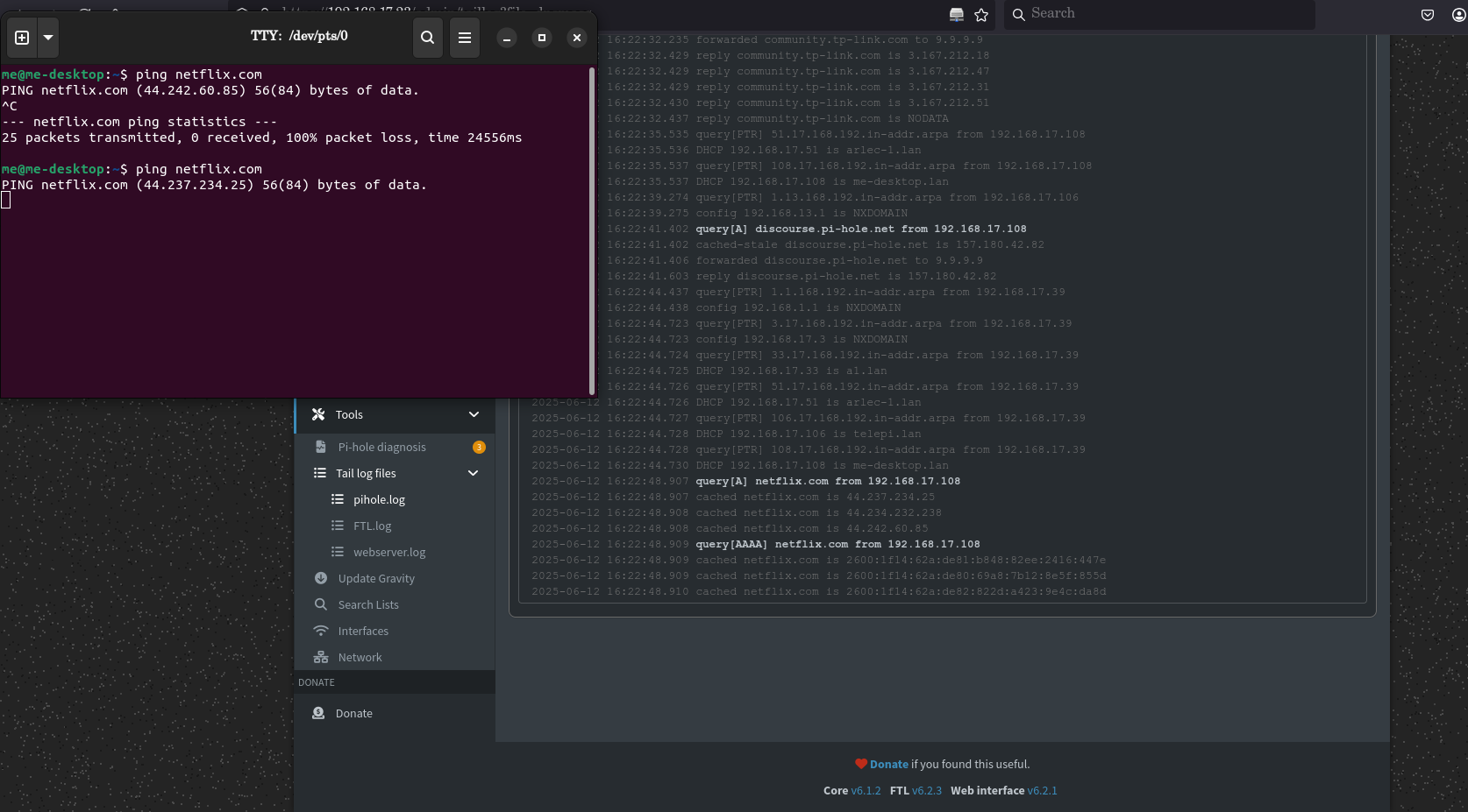

Ok, to clarify:
The PING is being blocked.
But the browser isn't.
Log is here.
https://tricorder.pi-hole.net/N084fNdv/
Well, it seems I am more stupid than I thought.
With the new install - and I am sure with the one I had before the uninstall and reinstall the list was wiped from what I had.
Now I realise what to do, I believe it is now working.
