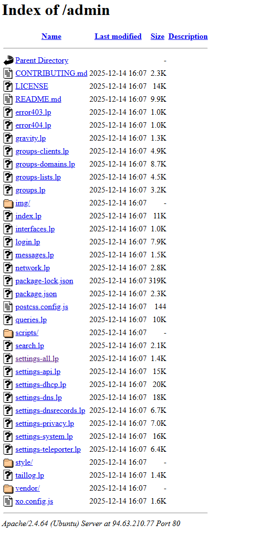

The issue I am facing: I have tried many things such as changing port
Details about my system: ubuntu 24 server on rpi 4 model B
What I have changed since installing Pi-hole: changed the port
Your image shows the issue - Apache is using port 80:
Pi-hole has its own web server (it doesn't use Apache) and both servers are configured to use the same port.
You need to move Apache or Pi-hole to a different port.

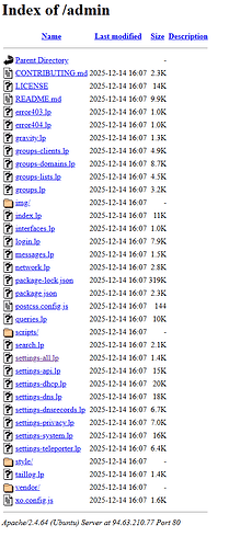

I have moved po hole to run on port 8080 in the config file
