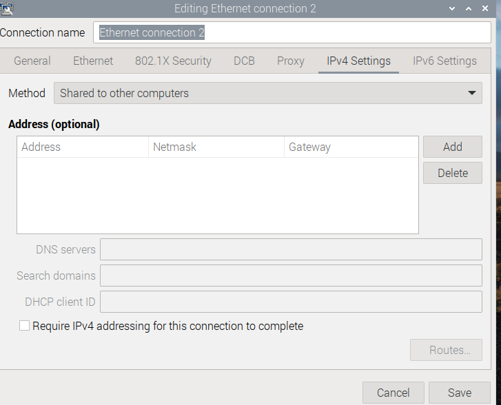

Thats not the case, it says NetworkManager but NetworkManager never updated the IP address since sharing was turned off
because all it says is
# Generated by NetworkManager
nameserver 192.168.1.252
nameserver 1.1.1.1
like I said though NetworkManager has not touched it

I have had this issues from July 2024, and now I know what happened and actually it was user error with the host /etc/resolv.conf, the host system used to run NetworkManager sharing a wireless connection over ethernet, in July 2023 we changed ISP, then a few months later (as I thought) I ran a direct ethernet link to the router in May 2024 with powerline, so the NetworkManager link was no longer needed, resolv.conf never got updated, and I never thought to check

That's a strong indication that resolv.conf is under NetworkManager's control.
That doesn't mean that you cannot apply changes to that file manually, but you should expect them to be reverted to NM's information upon certain events, like connecting to a network, rebooting, renewing DHCP lease information or NM package updates.
I'm not sure what sharing you are referring to, but to prevent NM from touching resolv.conf, you'd usually change its dns option.
For the host (not inside the docker container), below is relevant again:
You can see whats configured in NetworkManager (for DNS) if run below:
sudo nmtui

Like I said not anymore not since July
If would be if I did not know the history of the configuration for Network Manager

the first line says "generated by NetworkManager" but the setup that made the change in not being used anymore
Its solved and why would I send my full Network Configuration
that shows the main connection, but that uses DHCP and router DNS, the system does not seem to ever use this interface but instead uses macvlan interface that run the docker containers,, but the host also uses that over the Ethernet

I know Network Manager has not touched that file, as the DNS IP was incorrect, it would change it to 192.168.1.1(Router)
The fact is now its working
I will do a full host reboot, and show that /etc/resolv.conf stays unchanged
its still that same, everything still works
nothing was updating /etc/resolv.conf on the host
