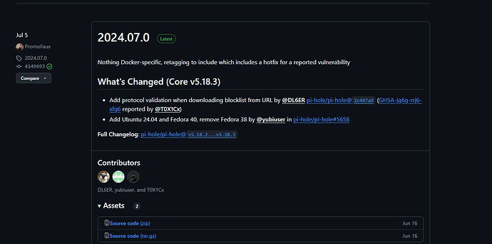

I am running 2024.07.0

Is there a reason you are running an outdated docker image?
Sorry, I read the docker image tag as 2024.01 (January).
