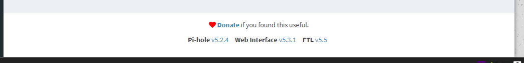

Sorry for this noobie question, but is it visible from the Dashboard whenever an update is available? I can see the version numbers, but no indication that an higher version exists.
It doesn't always reflect immediately, but it's in the footer of the page where the versions are shown:
It will say "update available" here. Though I can't remember off the top of my head how often that check is done. @DL6ER might remember....

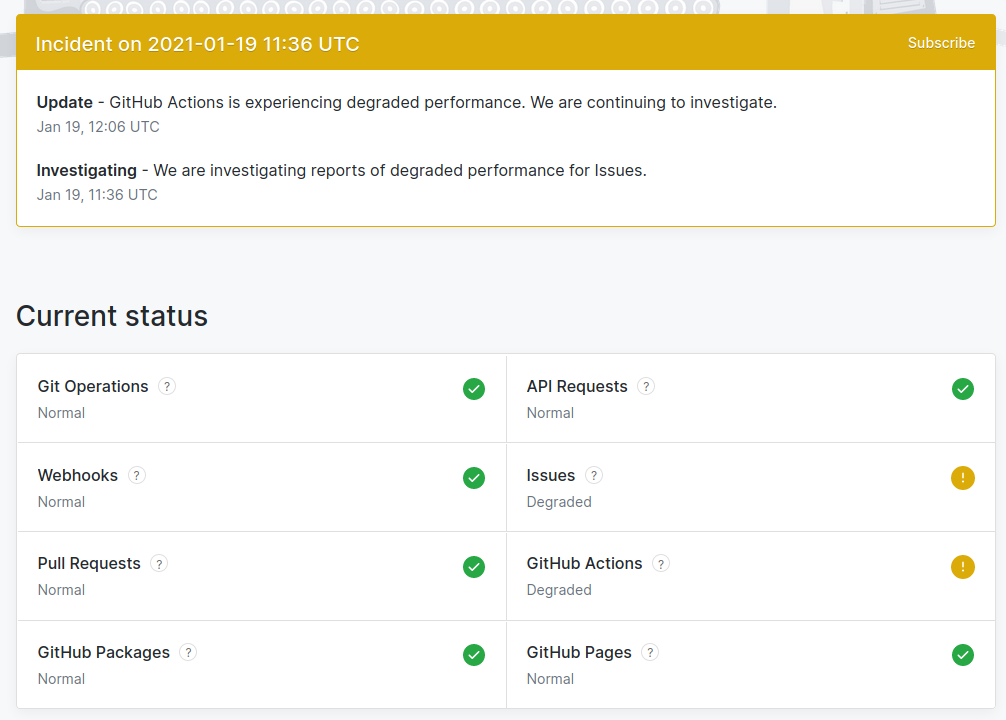

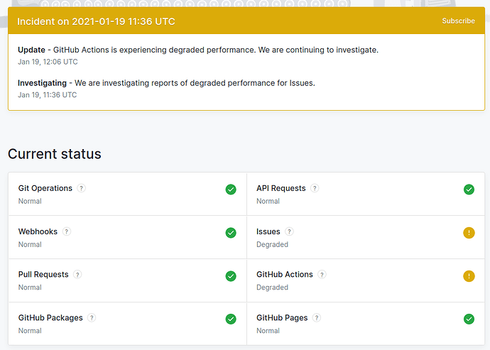

[i] Downloading and Installing FTL...curl: (56) SSL read: error:00000000:lib(0):func(0):reason(0), errno 104
[✗] Downloading and Installing FTL
Error: URL https://github.com/pi-hole/ftl/releases/latest/download/pihole-FTL-armv7-linux-gnueabihf not found
[✗] FTL Engine not installed
Try again. There have been some reports lately of failing FTL updates. Usually it worked if tried a second or third time.
is every dns provider (google, cloudflare) vulnerable to these vulnerabilities and has to fix them himself? Does that mean pihole is safer?
Github is reporting issues. This is probably why your download failed and outside of where we can so something to fix it.
