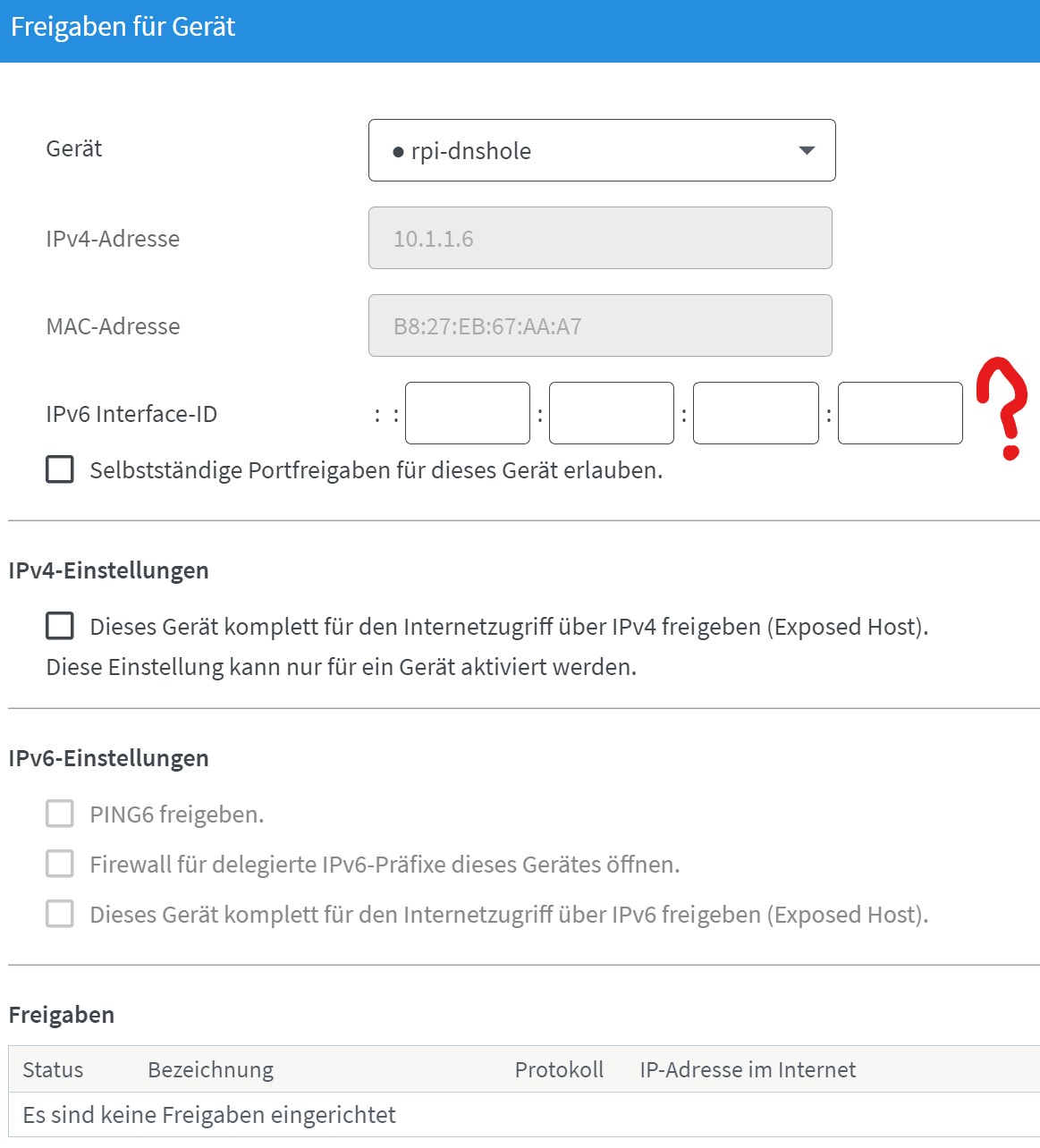

Pi-Hole
This is how my Pi-Hole Server looks in FritzBox network details. As you can see, it has no interface ID assigned, and no local fe80: address. There is not even the input box to enter/change the Interface ID.

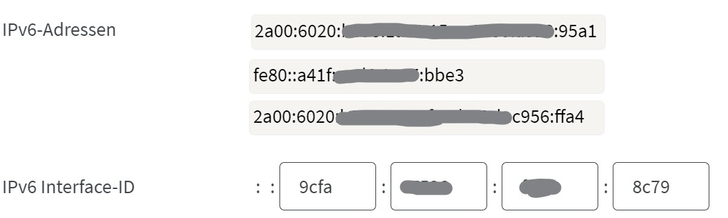

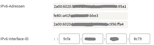

All other devices
This is how the IPv6 network details look for literally all other devices on my network. As AVM support told, the devices automatically determined their Interface ID with the FritzBox.

Seems in the port forward setup I can manually enter an ID, but AVM support told me that I don't have to, since it's configured automatically per router advertisement. Pi-Hole syslog shows me that the Router Advertisements (RA) are received periodically.
Now I'm totally confused. Can I invent some ID and enter it here in the FritzBox config? Or how would I determine the ID to be entered on the Pi-Hole?

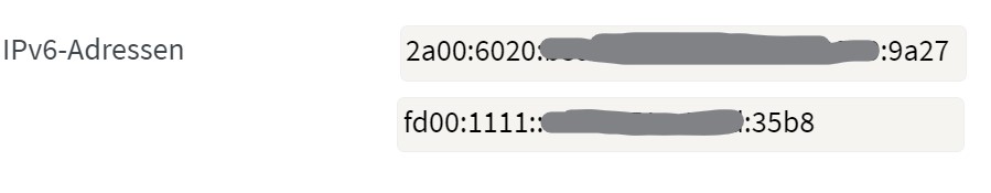

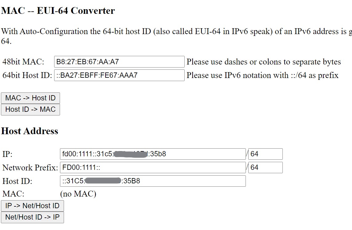

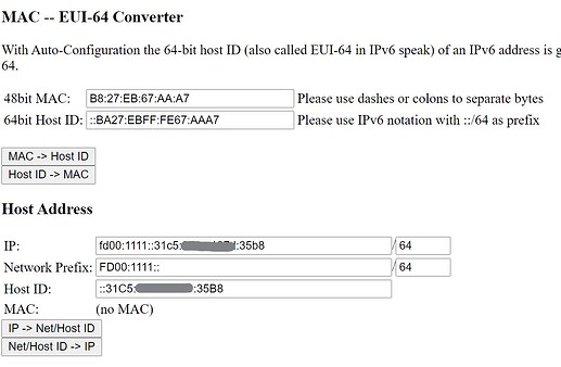

Is it maybe as simple as this?
Is the calculated Host ID in section Host Address = IPv6 interface ID?
Do I use the local fd00: address for the interface ID, or the other one with the 2a00: prefix?
