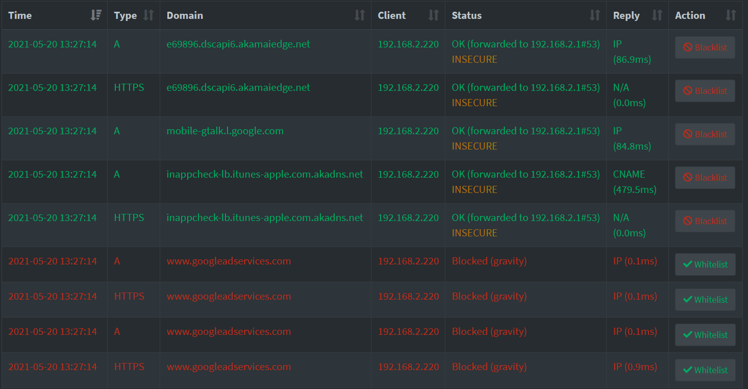

Pi-Hole sends the answer to the IP that requested the DNS - always.
When starting my iPhone YouTube app (or when opening youtube.com with firefox on my computer) Pi-Hole sends the answer to the wrong IP (to my router ; FritzBox 7590) - not to the device that asks for the DNS / IP. Other requests work fine (as I can say for now)!

I think there may be some confusion in terminology here.
The Forwarded to... message is the IP address of the upstream dns server, which you have set as 192.168.2.1.
The result is then returned to the requesting client
Simply put:
  • 192.168.2.220 wants to know the IP address for mobile-gtalk.l.google.com
  • 192.168.2.220 sends a request to your Pi-hole 192.168.2.70
  • Pi-hole does not know the IP address for mobile-gtalk.l.google.com, so it forwards the request onto the upstream server 192.168.2.1
  • 192.168.2.1 returns the IP address to your Pi-hole 192.168.2.70
  • 192.168.2.2=70 returns the IP address to the requesting client 192.168.2.220
If I've wildly misunderstood your query, please let me know :slight_smile:

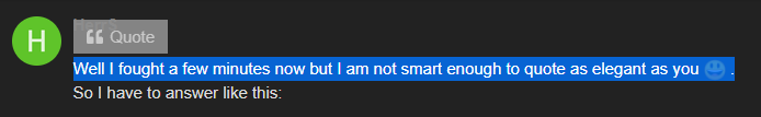

Well I fought a few minutes now but I am not smart enough to quote as elegant as you :smiley: .
So I have to answer like this:

Simply highlight the text you wish to quote, and then hit the "quote" button :slight_smile:
