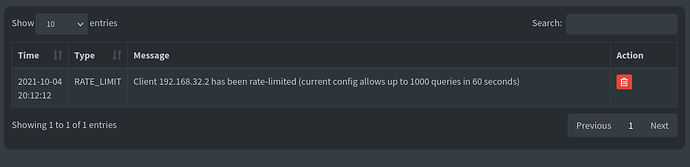

Hi! I'm running Pi-hole on a Raspberry Pi 4B 4GB with Raspbian. I combined Pi-hole with unbound and PiVPN. I also use it as a DHCP server. For a couple of months my queries have been flooded by the infamous .in-addr.arpa PTR requests. Because everything else seems to work normally I never bothered with this annoyance until now but I really want to solve it since it makes my statistics unreadable and because I worry something else might be broken. Yesterday I updated Pi-hole to the latest version (after approximately 4 months without updating) and this warning started showing off:

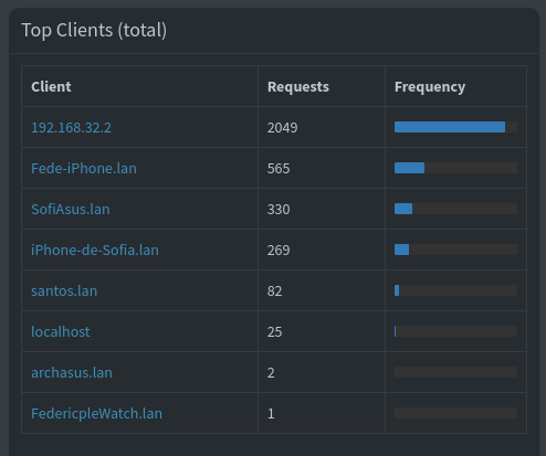

What is also weird about all of this is that the requests are made by the IP 192.168.32.2. I have no idea which of my devices uses that IP. I've seen threads of other people with the same problem but I couldn't find any way to solve it. I don't have Conditional Forwarding enabled so I don't think that could be a problem. I reviewed my modem settings and everything seems to be normal.

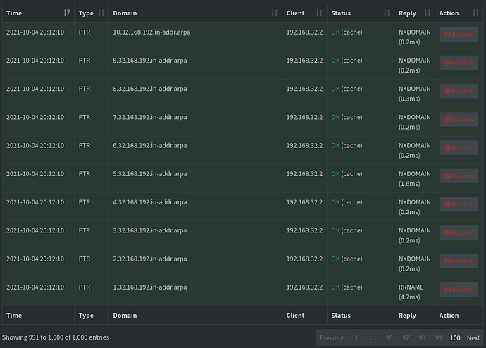

2049 requests were made:
First requests:

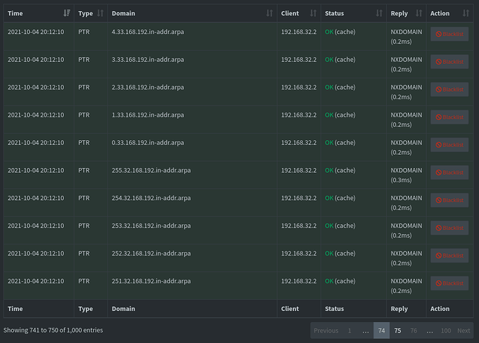

They go up to 255 and then increment by one:

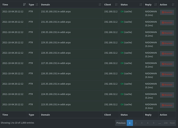

Last requests:

Did you have changed your network network range in the past from 192.168.32.XX? Do you have any device with you might have setup with a static address of 192.168.32.2?
No and no. The only thing I did recently was update pihole with pihole --up. I think the culprit might be the raspberry pi or the modem at most, I don't think there's another device doing this. I don't know why it would make all these requests either.
Edit: Using nmap I couldn't find any device on the 192.168.32.x range...
