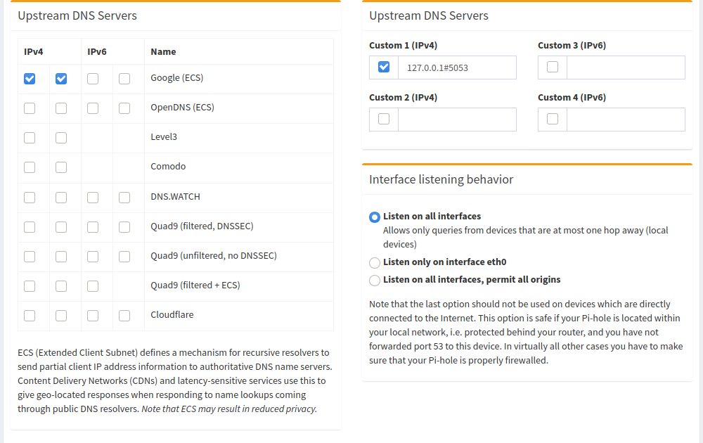

In the admin console, the only DNS servers checked are for Google. Is there a setting somewhere else I'm missing?
I've restarted the Pi and run pihole -d again. Here's the new Pastebin. I don't see Cloudflare listed in the DNS variables, though I have configured DNS-over-HTTPS (using the manual method), which uses cloudflared.
Look at your Custom1 DNS server. Check box is checked.
Yes, I set it in accordance with the DNS-over-HTTPS docs.
