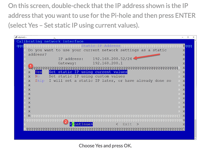

When setting up pi-hole with the crosstalk solutions tutorial (with the command pihole -r), I had the option between eth0 and wlan0 (I took eth0 given that it was what I set up the raspberry pi with). Before that however, I set up the raspberry pi with the router (so that it uses a fixed ip address via ethernet).
This was odd given that usually I should've seen this menu.
Here's the link for the tutorial: https://www.crosstalksolutions.com/the-worlds-greatest-pi-hole-and-unbound-tutorial-2023/
For most OS installations, you'd never see that message, except when dhcpcd would be used for managing your network on RaspberryPi OS. Beginning with 11/Bullseye, RPi OS has shifted to use NetworkManager as network management tool, and use that as its default since 12/Bookworm.
Your debug log shows you to run your Pi-hole RPi on Debian 12 (probably RPi OS (64bit)), so you would have seen:

This would suggest that your RPi 4 would lose its IP once its previous DHCP lease from your router expires.
You should try to manually set a static IP address on your RPi 4, e.g. via NetworkManager's nmtui.
