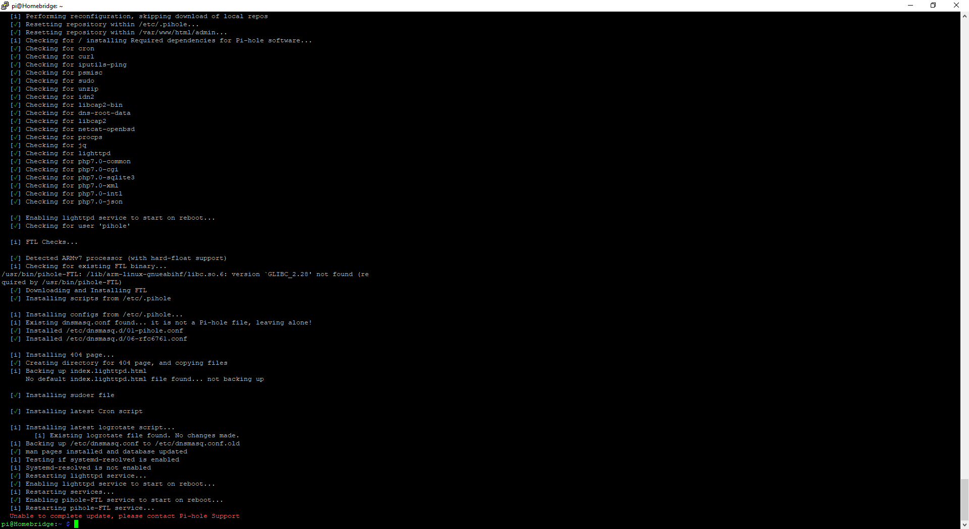

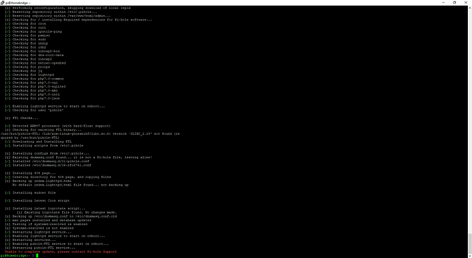

/usr/bin/pihole-FTL: /lib/arm-linux-gnueabihf/libc.so.6: version `GLIBC_2.28' not found (required by /usr/bin/pihole-FTL)
please see screenshot on where I found this error.
https://tricorder.pi-hole.net/i09kMt5G/
