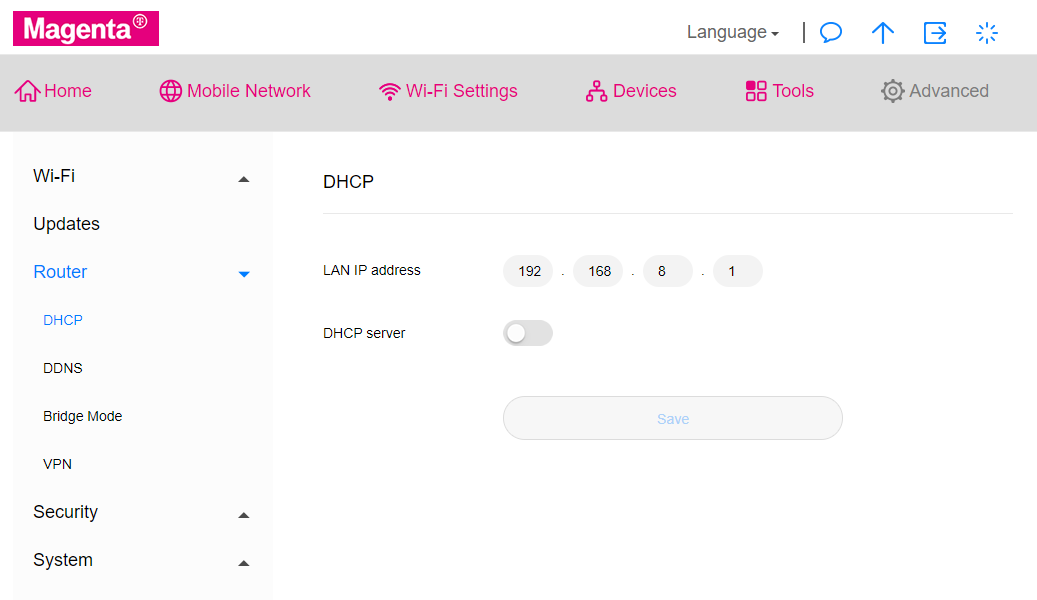

Hello! Thanks for your reply. I already tried to set Pi-Hole as DNS, but my router doesn't have any DNS settings in DHCP, but I have DDNS there. Is DDNS the same as DNS?
No it's not.
If you can't set the DNS server in DHCP settings, can you disable them completely? Because you could activate Pi-hole's DHCP server instead.
If deactivating is not an option, you could limit your routers DHCP pool to a single address and assign this permanently to your Pi-hole device. Additionally, enable Pi-hole's DHCP server with a non-overlapping DCHP IP address range.
Thanks! I saw an option to disable it, so I will try it. Do I have anything more to do after that?

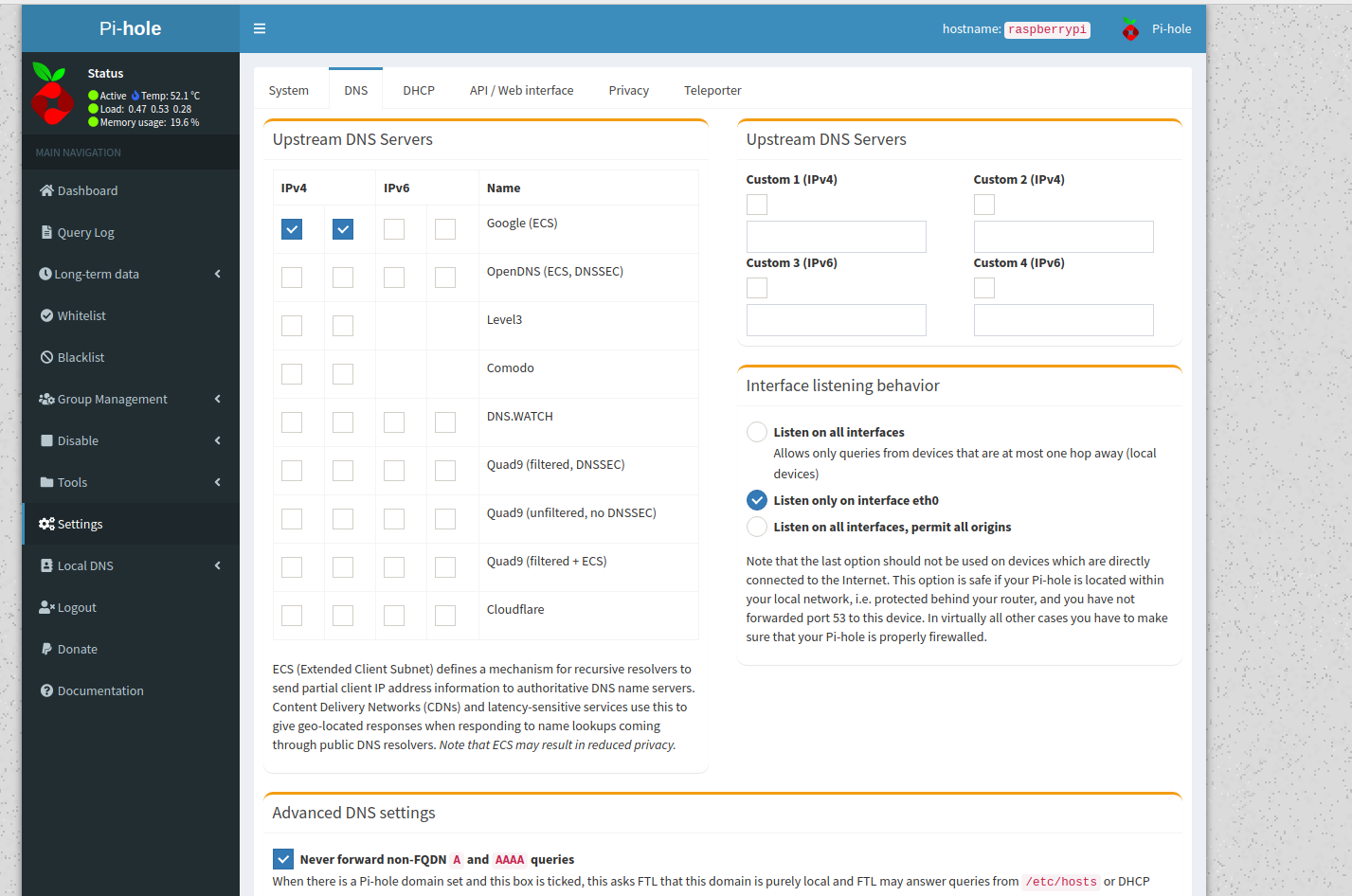

By the way, DHCP is disabled on my router... And I didn't change anything in the pi-hole DNS settings. Could that be a problem? There is still the google dns server selected.
