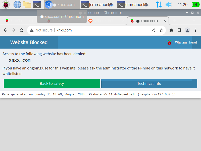

I install your service yesterday. This work good on my raspberry os that i implement with virtual box . Unfortunalty , nothing work on my router. So when i try banned adress by Pi-Hole on main os or on other devices in my network , i can access.

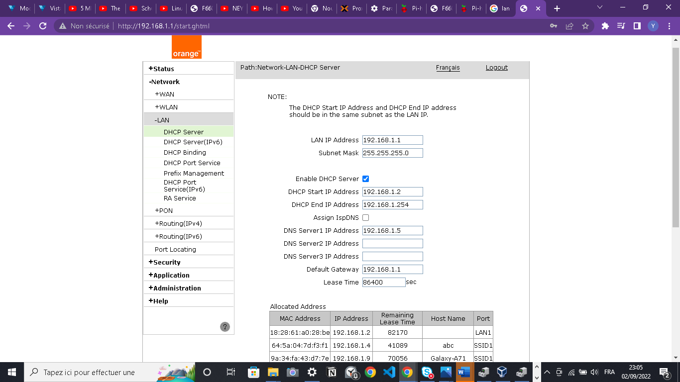

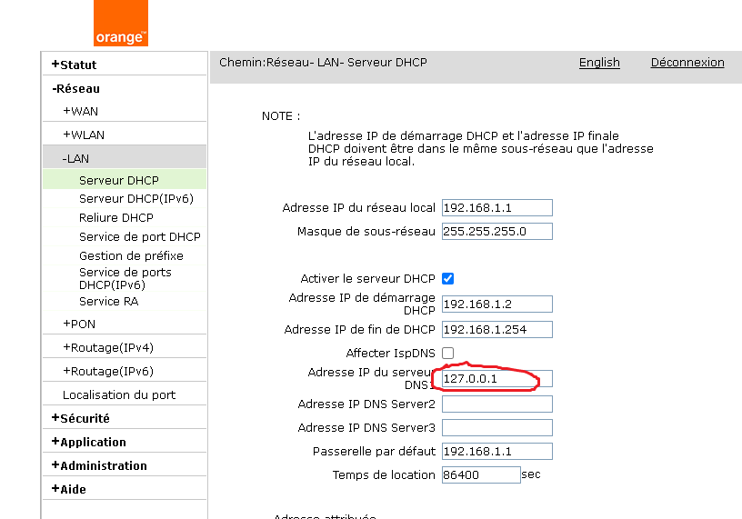

By the way , i change the dns adress on dhcp settings on my router and i put the adress of pi-hole .
I don't know if i do that correctly
Let's start with the debug token.
The loopback IP you have listed in the router settings is incorrect. Your debug log will show me the correct IP to use, and also show if there are any other problems with your Pi-hole install.

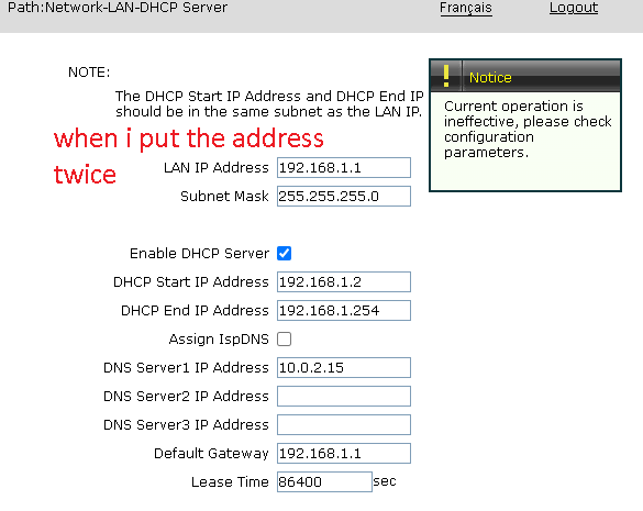

This is what you enter in your router DHCP page. Enter it twice (put it in Server2 as well) if the router configuration page will let you.
Then renew the DHCP leases on all clients.
i already enter this ip , i enter again but nothing work. Also , I can't type the ip adress in the both side .
Your DHCP range is different than the IP of the Pi-hole.
The router is using the range 192.168.1.x, but Pi-hole is on a different private LAN range - 10.0.2.x.
You need to resolve this.

I success to put my virtual machine into my network .

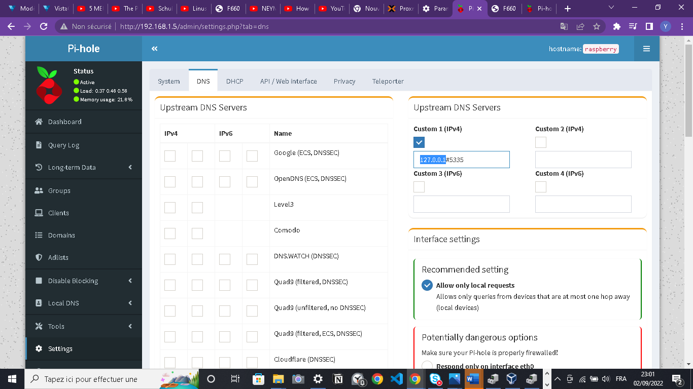

I have a new pi hole ip : 192.168.1.5
i can now access to pi-hole interface in my main os
but the blocker still work only in my rapsberry pi os and not in my all lan
thans for your answer , that helped me very well
