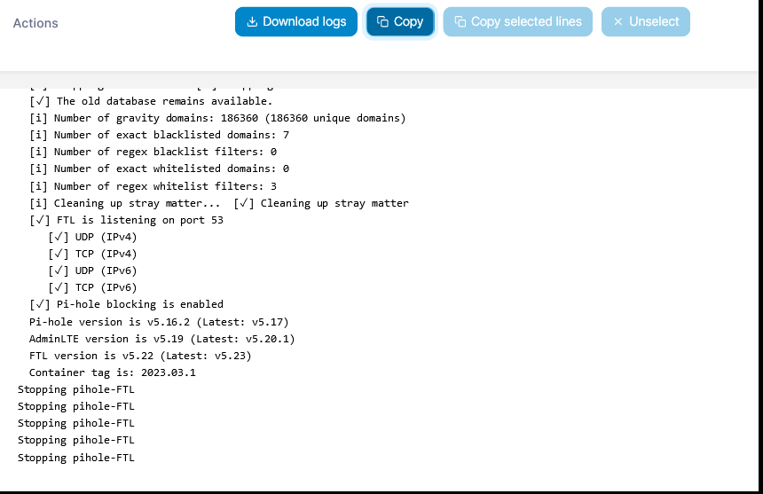

Let's try to see some logs from your container.
Please, stop and start the container again, then go to the container Log screen (on Portainer):
Log icon (highlighted)
Then on the Log screen, click on the Copy button:
and post the logs here.

2023-06-04T16:31:10.307460894Z s6-rc: info: service legacy-services successfully stopped
2023-06-04T16:31:10.307541708Z s6-rc: info: service _postFTL: stopping
2023-06-04T16:31:10.323862820Z s6-rc: info: service _postFTL successfully stopped
2023-06-04T16:31:10.323944633Z s6-rc: info: service lighttpd: stopping
2023-06-04T16:31:10.401341569Z Stopping lighttpd
2023-06-04T16:31:10.457902422Z s6-rc: info: service lighttpd successfully stopped
2023-06-04T16:31:10.458000050Z s6-rc: info: service pihole-FTL: stopping
2023-06-04T16:31:10.503894930Z Stopping pihole-FTL
2023-06-04T16:31:10.520756886Z s6-rc: info: service pihole-FTL successfully stopped
2023-06-04T16:31:10.524756642Z s6-rc: info: service _startup: stopping
2023-06-04T16:31:10.538606920Z s6-rc: info: service _startup successfully stopped
2023-06-04T16:31:10.538775713Z s6-rc: info: service _uid-gid-changer: stopping
2023-06-04T16:31:10.548619069Z s6-rc: info: service _uid-gid-changer successfully stopped
2023-06-04T16:31:10.548761029Z s6-rc: info: service cron: stopping
2023-06-04T16:31:10.589584429Z Stopping cron
2023-06-04T16:31:10.603182951Z s6-rc: info: service cron successfully stopped
2023-06-04T16:31:10.603630778Z s6-rc: info: service legacy-cont-init: stopping
2023-06-04T16:31:10.637163636Z s6-rc: info: service legacy-cont-init successfully stopped
2023-06-04T16:31:10.637976495Z s6-rc: info: service fix-attrs: stopping
2023-06-04T16:31:10.651347650Z s6-rc: info: service fix-attrs successfully stopped
2023-06-04T16:31:10.651438574Z s6-rc: info: service s6rc-oneshot-runner: stopping
2023-06-04T16:31:10.703588826Z s6-rc: info: service s6rc-oneshot-runner successfully stopped
And it stay in status exited until I redeploy the container.
