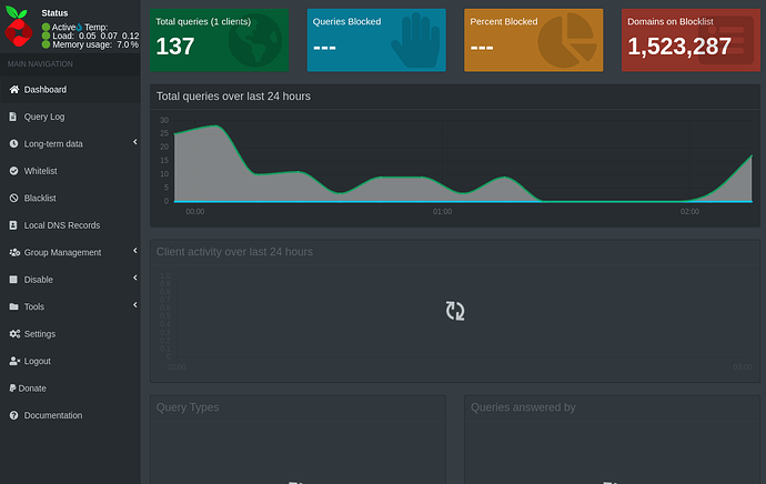

The dashbord looks as follows:
It looks like Pi-Hole works only on the localhost machine. If I add the IP address of the Pi-Hole Raspberry server manually on a client in the same network, I can't load any website.
