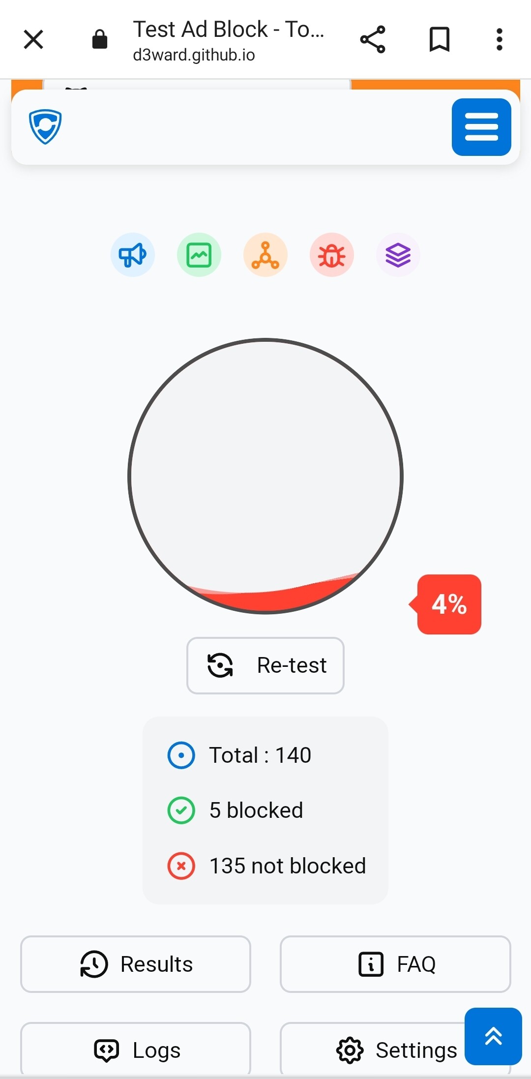

Pi-hole adblock is not working.
Ads are still shown as before

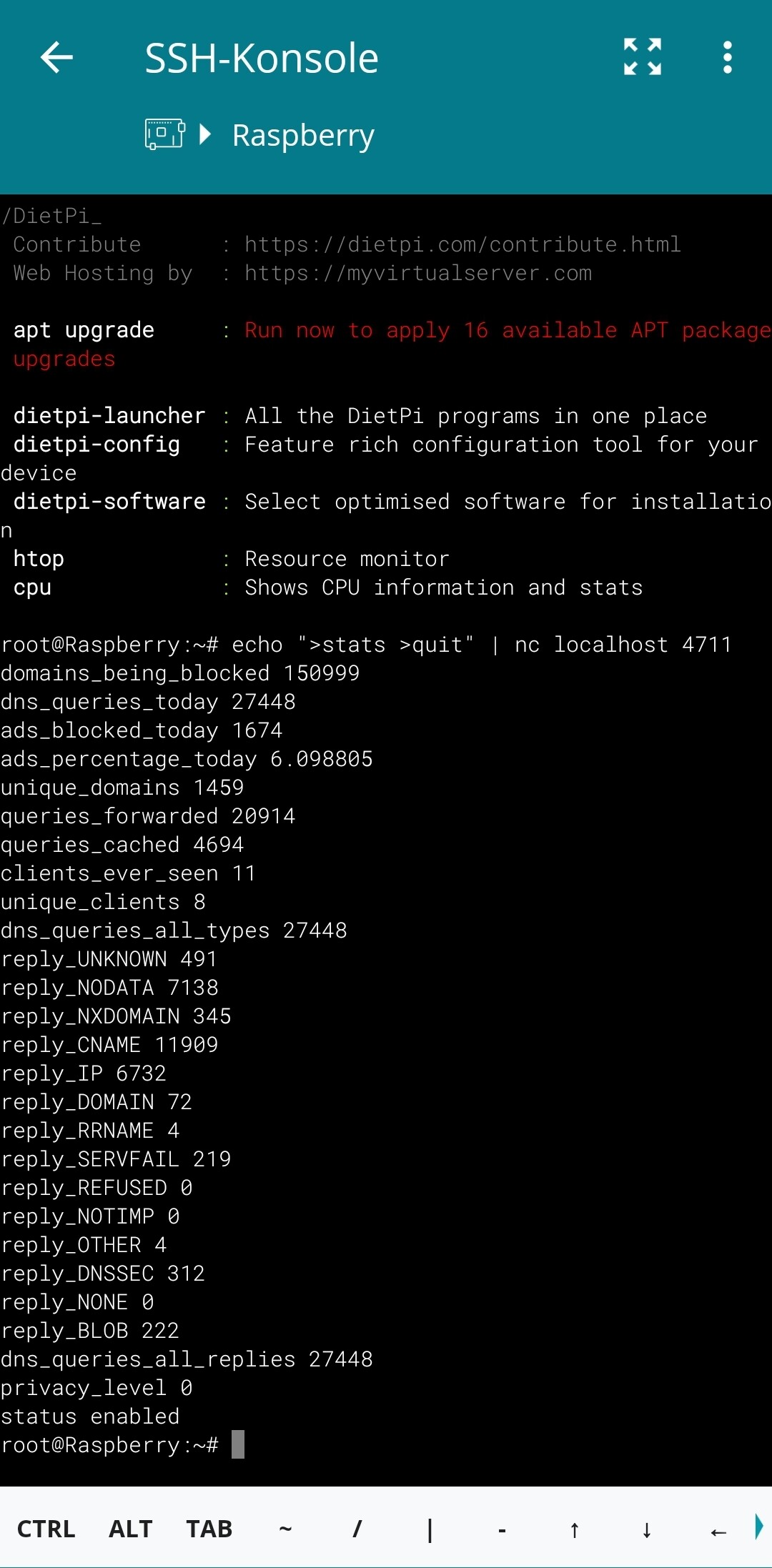

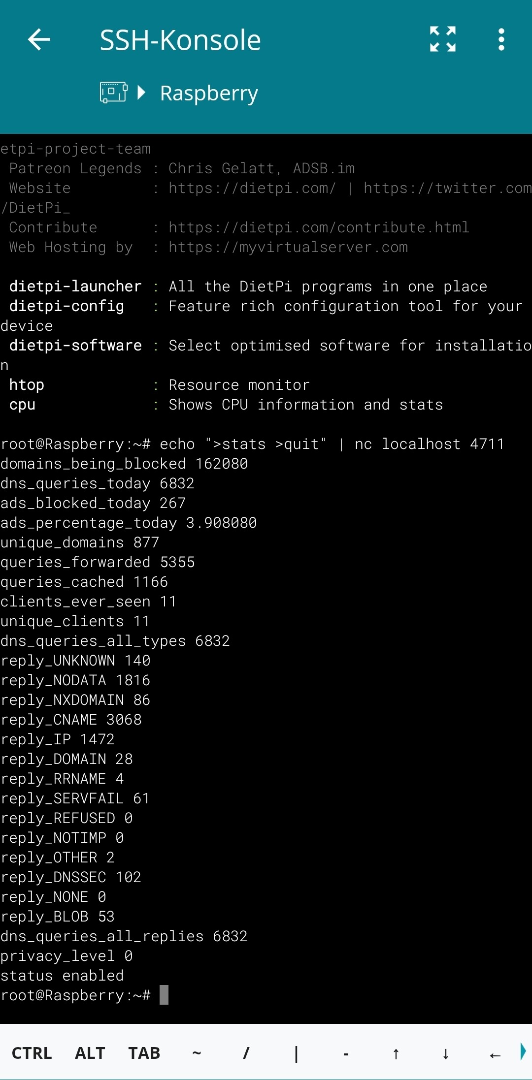

Run from your Pi-hole machine, what's the output of:

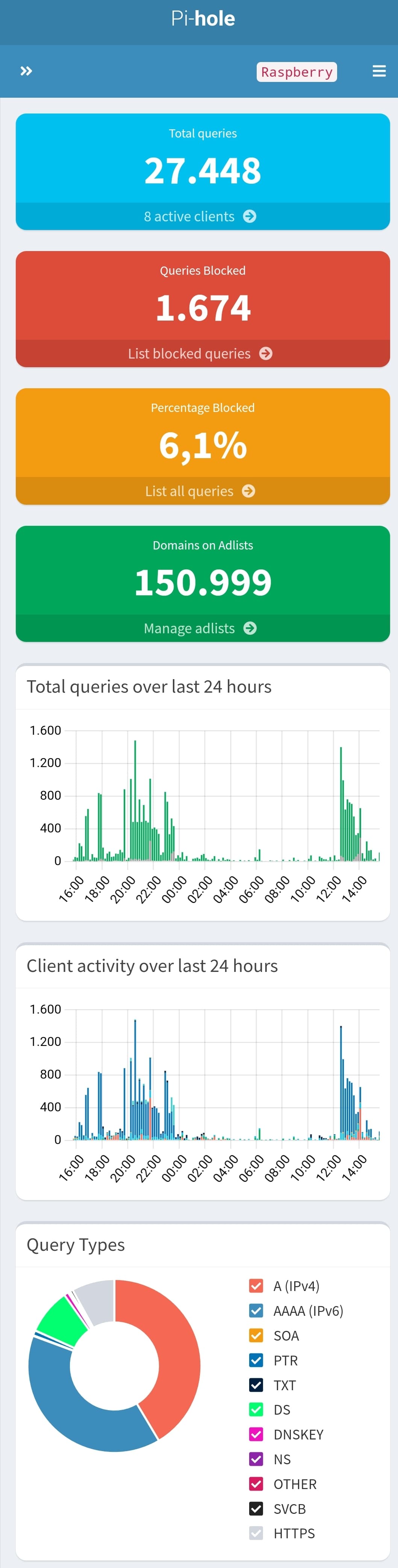

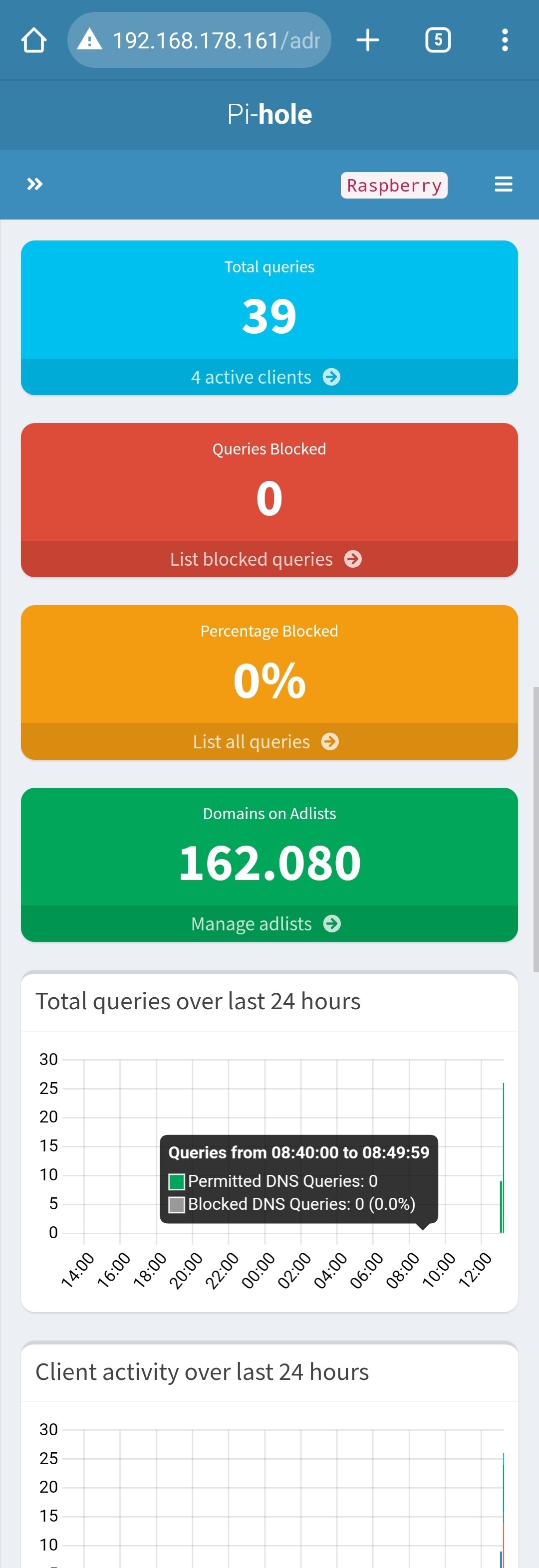

If you compare those stats output with Pi-hole's current UI info (probably immediately after rerunning those stats), would they match closely?
What is the command for the current UI info?
I meant to compare a current stats output with the information as shown on your Pi-hole's UI.
It's matching

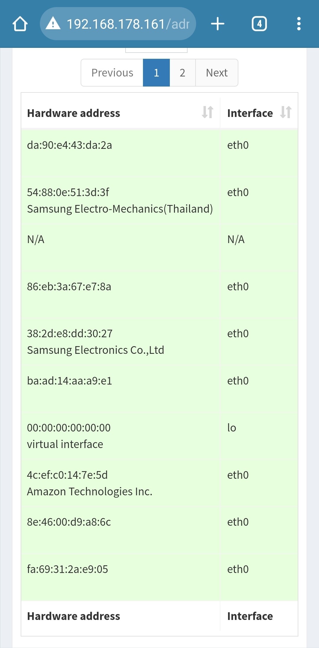

Is Eth0 correct for mobile devices?
My raspberry is via lan connected to my router
The Interface here is the interface from Pi-hole host machine.
In your case, your Raspberry Pi has only one active interface (eth0).
Some machines may have more than one active interface and this page will identify them.
