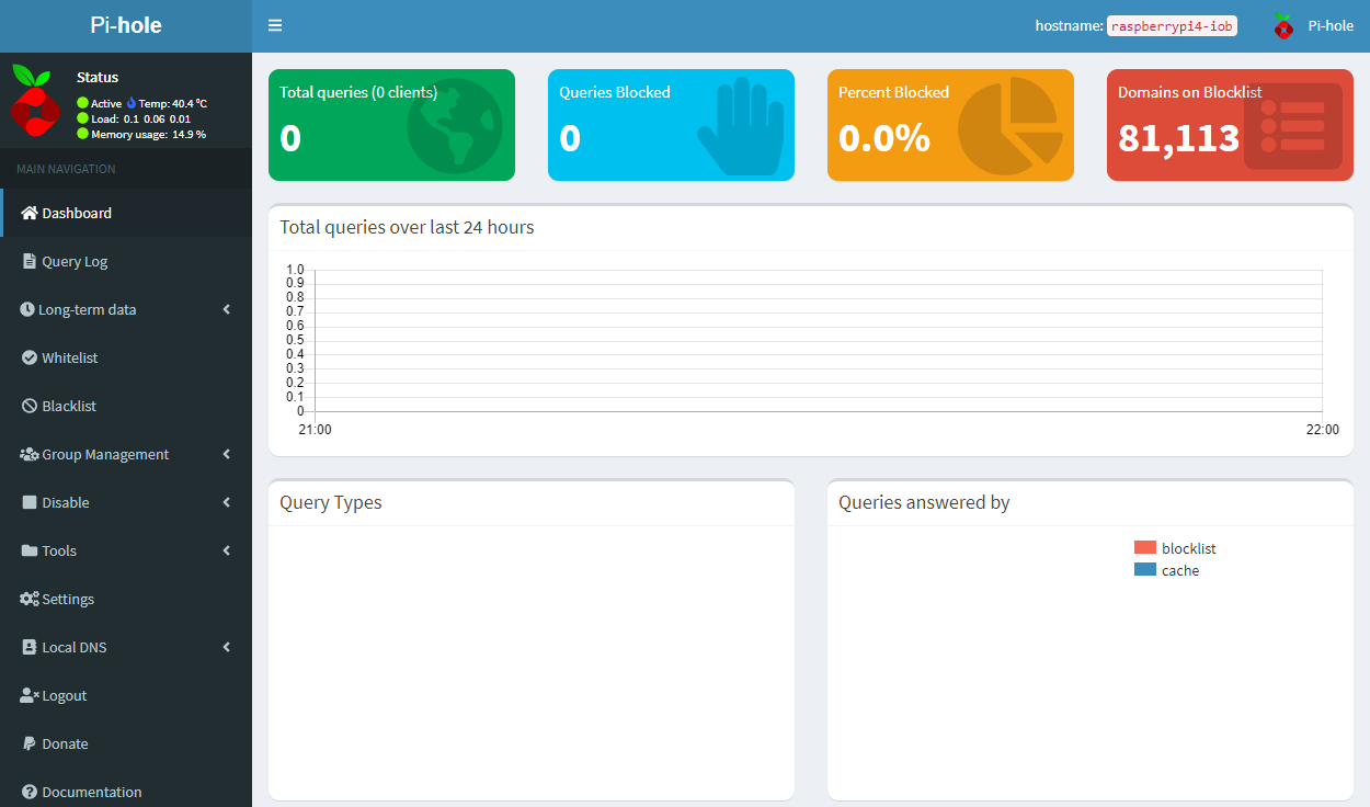

Here is a picture what I see in the Dashboard:

Pi-hole isn't blocking because it's not being used.
Having another DNS as alternative will almost always end up with clients using the alternative DNS and not Pi-hole.
