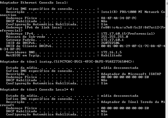

Check ipconfig /all from a command prompt in the computer getting ads to confirm your pi-hole's IP address is your only DNS server.

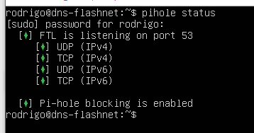

Also, on the vm, type "pihole status" from a terminal to make sure it's blocking.
this way running the cmd you said.
Great, pi-hole is up.

Your DNS server is in another network than your PC. Does your PC have reachability to the Pi-Hole VM (can you ping it from your PC)?

I find it interesting that your PC can still browse the internet. If 172.16.1.5 is your Pi-Hole and it didn't work, then you wouldn't be able to do DNS queries as you don't have any secondary DNS setup. I'm not entirely sure if I have a good grasp of your network though.

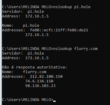

Run from a client in your network, what's the ouput of
nslookup pi.hole
nslookup flurry.com

Go to cmd on one of your PC that doesn't get adblock. Then run these commands in cmd:
nslookup pi.hole
and
nslookup flurry.com

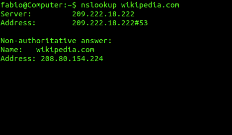

Here is an example:
The result for the first command looks ok - your client has been using Pi-hole for that DNS request.
But flurry.com should have been blocked by Pi-hole.
