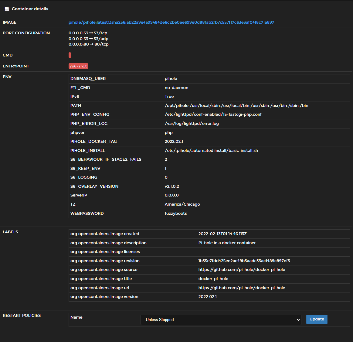

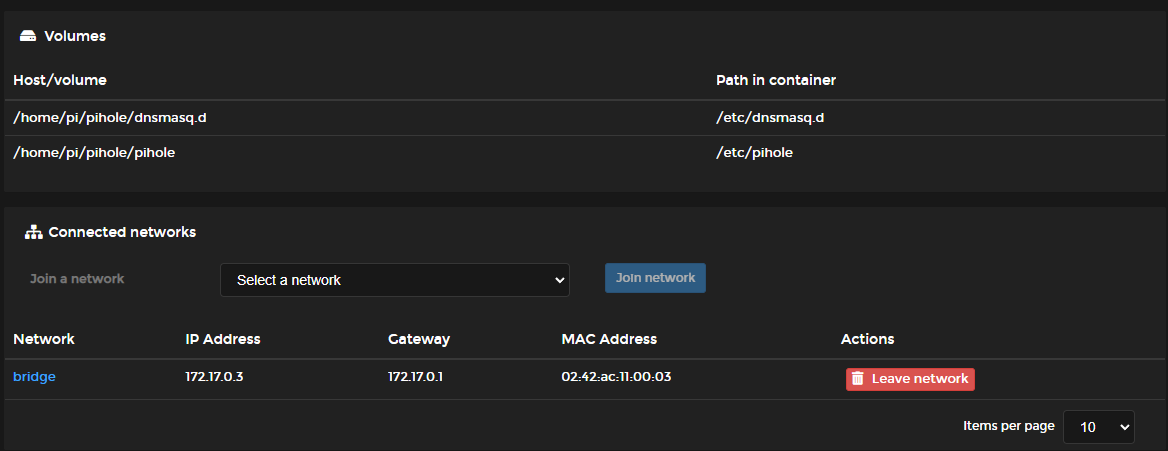

I started from scratch using the sample config and was given similar results. I'm not entirely sure what the deal is. I've nuked it and have actually redeployed pihole using portainer this time around. Was able to bring it back up without any issues but anytime I set my DNS to pihole and make this my only DNS entry (for testing purposes) I get nowhere:
[âś“] Your debug token is: https://tricorder.pi-hole.net/Frox6RyQ/
[i] Logs are deleted 48 hours after upload.
Perhaps me using portainer would have to be another conversation or another thread, but I just didn't know what else to try.
