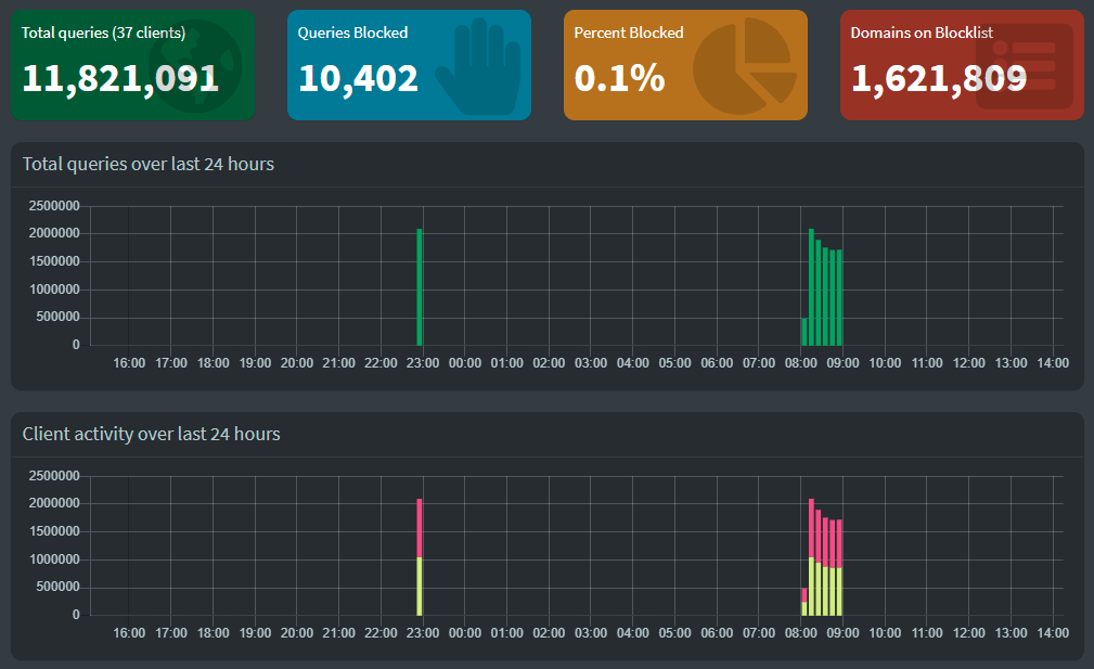

I don't think this is actually a pi-hole issue, to be honest. I recently discovered that random wireless clients on my LAN are unintentionally DOS'ing my router via DHCP renewal requests, and I recently made changes at my router to try and mitigate the bad behavior. Since then, the traffic on my pi-hole has ballooned dramatically, which I assume is what caused pihole-FTL to crash the last two days.
Sorry to cross-post, but here's the OpenWrt thread where I'm trying to troubleshoot the LAN DOS'ing issue: Limiting active connections per client using rate limiting and conntrack - Installing and Using OpenWrt / Network and Wireless Configuration - OpenWrt Forum
At this point I'm not sure if it's better to close this thread since I don't think pi-hole is to blame, or if anyone here might happen to have any suggestions for configuration changes I can make to my pi-hole to make it more resilient against being flooded.
11.8 million queries in 24 hours likely led to memory exhaustion on the Pi. That's a lot of queries.

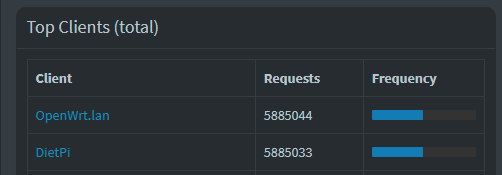

echo ">top-clients >quit" | nc localhost 4711
0 5885044 192.168.1.1 OpenWrt.lan
1 5885033 fd1a:25d6:5a17::1 DietPi

That's your problem. The arpa query is an mDNS query (multicast DNS). Query volume is likely exacerbated by the conditional forwarding.
That is 2.5 GB, pretty large. The database is storing all your queries, and with 11.8 million a day it grows pretty quickly. If you don't mind losing your database (which is so large it has limited usefulness), run the following commands to delete it and start a new one. With conditional forwarding disabled, your queries should be under control and the database won't grow so quickly, and Pi-hole will be able to load the previous 24 hours of data on a restart without failing.
Note the alternate option below that if you want to keep your existing database for future reference.
