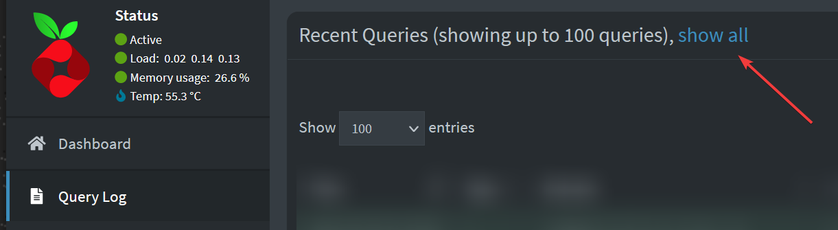

The install works fine for the entire network, apart from when I visit "Query Log -> show all", as shown in the following screenshot:
When pressing this, the Pi-hole will take a little time to process the data. However, while this is being processed, no DNS queries are answered.

<SHOW ALL PRESSED>
C:\Users\User>nslookup www.google.com
DNS request timed out.
    timeout was 2 seconds.
Server:  UnKnown
Address:  192.168.1.2
Once the processing has finished and the results are shown in the web UI, the DNS lookup starts working again. DNS responses only stops working while the processing is taking place.
