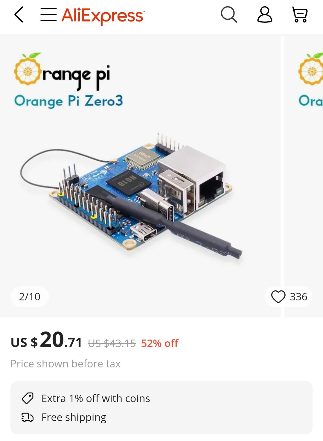

How could the one in the photo work? It seems to me that they are at the same price as the Raspberry Pi Zero, but here they do not charge shipping, plus it has an RJ45 input.
And how complicated can it be? I know absolutely nothing about these mini boards
Should work fine.
Not very. Get the SBC, a power supply of adequate capacity, and an SD card (recommend a good quality 32 GB card to extend card life). And an ethernet cable if you connect it to the LAN via ethernet.
Flash an OS on the card from your computer (Raspberry Pi Imager recommended), put the card in the SBC and boot it. You can set up SSH with the imager or by putting a blank file named ssh in the boot directory of the card after you flash it.
Once the SBC is set up, install Pi-hole on it the same as you did on the VPS. You ssh into the Pi from your computer.
