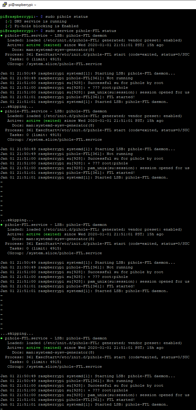

@Jawbone Sorry, as a regular forum member I'm not able to read your Pi-hole diagnostics report ... so, if you don't mind, start a SSH session to your Pi-hole and try these two commands and post back the results:
sudo pihole status
sudo service pihole-FTL status
Sorry, I can't figure out how to copy/paste out of putty so screenshot it is
http://prntscr.com/qin4p6

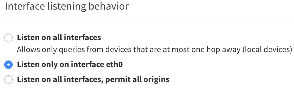

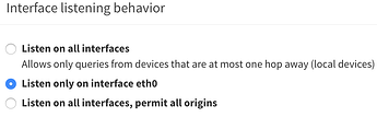

@Jawbone One thing I see is that the interface shows as wlan0, Is your Pi-hole connected to the network by Ethernet or by wireless? If the latter, try connecting by Ethernet. On the Pi-hole Settings > DNS tab what is your Interface Listening Behavior set to?
It should be as shown above.

I changed to "Listen on all interfaces" and it works!! It does not work if it only listens on eth0. Why should it only be on this setting? Is it a security issue? My pi-hole is connected wifi (eth0) and my desktop is lan to my router.
