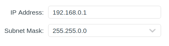

Router is 192.168.0.1, all clients receive that IP as their DNS IP when connecting.
PiHole is statically assigned IP 192.168.103.0 by the DHCP server running on my router, which covers my whole local subnet, 192.168.0.2-192.168.255.254.

2: eth0: <BROADCAST,MULTICAST,UP,LOWER_UP> mtu 1500 qdisc mq state UP group default qlen 1000link/ether dc:a6:32:30:0f:62 brd ff:ff:ff:ff:ff:ffinet 192.168.103.0/16 brd 192.168.255.255 scope global noprefixroute eth0
So the Raspberry Pi - and PiHole are bound to the entire subnet.

As stated in the post, I had to turn it from Local to Single because PiHole was not responding to requests on the 1.92.168.0.1/16 subnet, even though it is only using the eth0 interface bound to that subnet.
However it was only not responding when those requests came from the router (192.168.0.1) on behalf of the client. It was fine when they came directly from the other local network clients themselves.

Yeah, that’s the basic understanding I had for the definition of the phrase. I just have not been able to figure out how the current config doesn’t qualify for that. RPi and PiHole being bound to that whole subnet on eth0 works perfectly when the requests come from the clients directly but not when it comes from the router.

The router is at the bottom end at 192.168.0.1 and Pi-hole on the Pi's ethernet port is at 192.168.103.0 and it can reach the router and external servers no problem. Ad blocking is working correctly.
