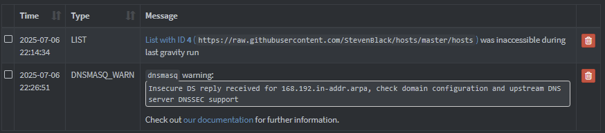

i've been running into these errors repeatedly, so I’ve put together a debug-log to help diagnose the issue.

Which line are you questioning? The LIST error or the DNSMASQ_WARN warning? If the latter, then you will have to ignore it for now, it's just a warning from the underlying dnsmasq process and it is being worked on by that packages author.
The list error
What does the output from a pihole -g run show for that list processing?

What could be the reason ?
This particular list was unavailable at the time the gravity update was run.
