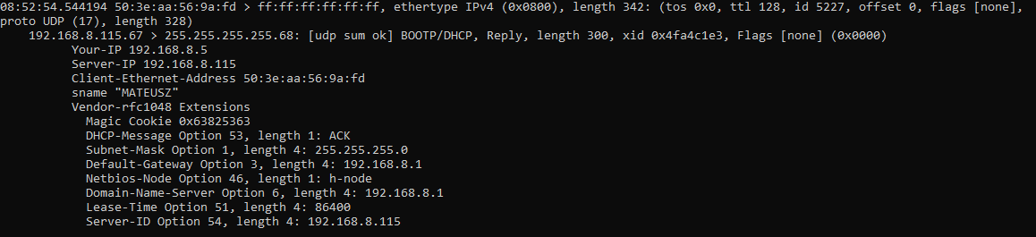

  • Wireshark when Im connecting to the network:
    Przechwytywanie

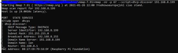

  • Nmap dhcp-discover:

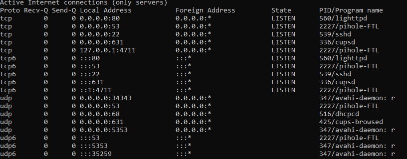

  • sudo netstat -lnptu

It's strange because when I type the command "pihole -d" and it scans DHCP, suddenly the wireshark logs appear
wireshark2
This only happens when I type "pihole -d"
