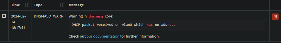

Just after running the debug the following message also appeared in my Pi-hole diagnosis
Warning in dnsmasq core:
DHCP packet received on wlan0 which has no address.

Unfortunately I can't run the Pi Hole fully just yet and I mainly use my router and shut down the Pi Hole. Whenever I switch on my Pi Hole's DHCP server and switch off the routers DHCP server I get the below warning.
Could this be pointing to what is causing the issue?

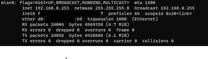

I read up what I could a possible error could be if the pi hole doesn't have a valid IP address and I ran ifconfig wlan0. Below is the results (not sure if this helps)

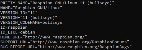

Your debug log has expired, can you please show the version of the OS you are using? It can be found in /etc/os-release.
A recent change to the Raspberry Pi OS (Version 12) moved from dhcpcd5 to NetworkManager for IP addressing.
Hi Dan
See below
Raspbian 11 is the version that uses dhcpcd5.
The warning of no IP address happens when there really isn't an IP address on the interface. I remember Raspbian doing odd things with the WiFi interface and using power saving features to turn down the interface. This may be something related to that.
