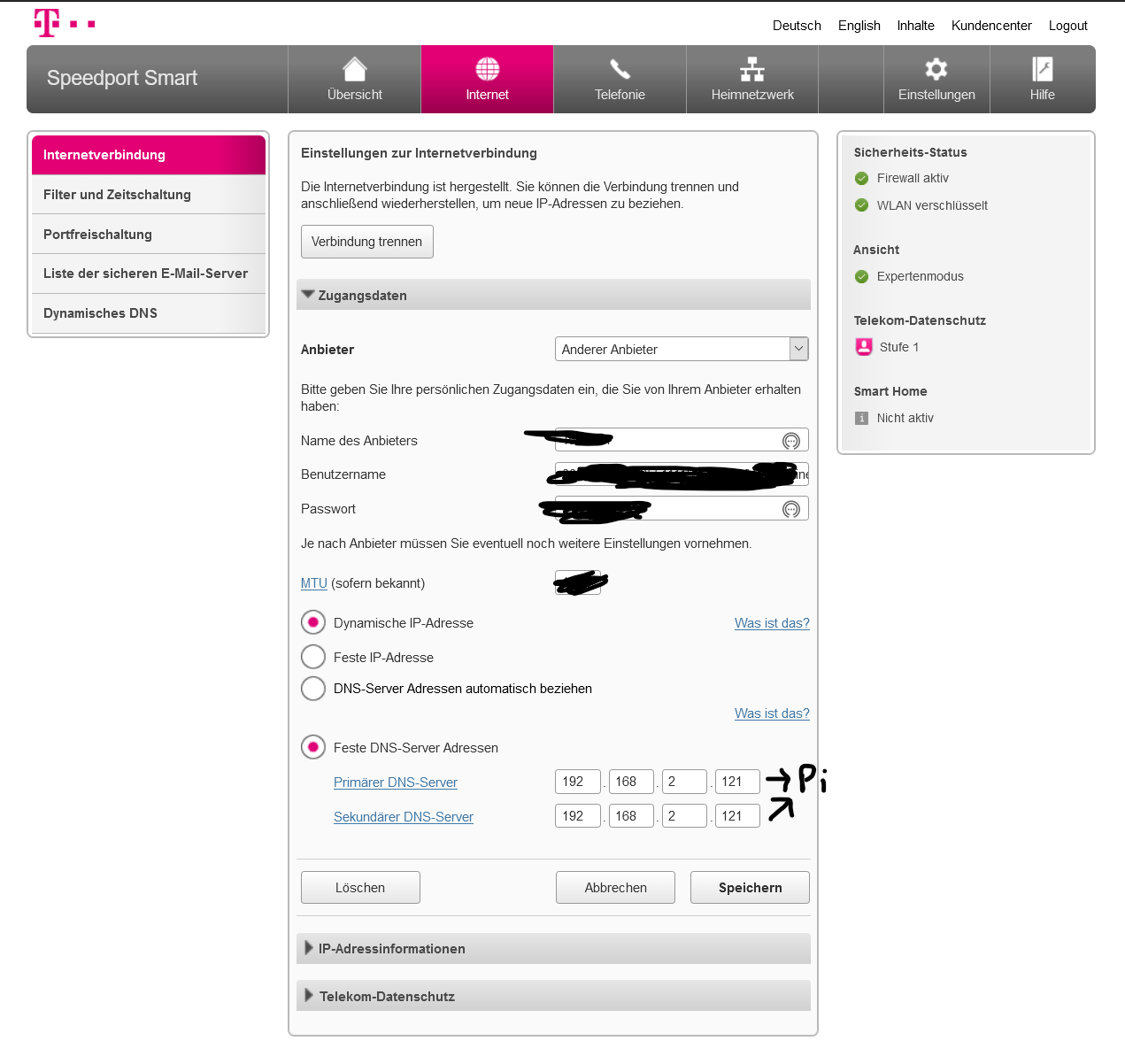

With DCHP enabled on the router and disabled on the pi all devices work properly. The issue with this solution is that I've to manually configure each device to use the pi as dns server. In order to solve this I tried to set the pi as the default dns server of my router (pic1).
Surprisingly, this didn't change anything.

Okay, so we can only assume that setting some internal IPs as DNS servers (as per your screenshor) does not do anything. This doesn't come all that unexpected. I had an even older Speedport before this one (which turned up in magic smoke at some point and was replaced) and there you were not even able to set anything DNS related...
