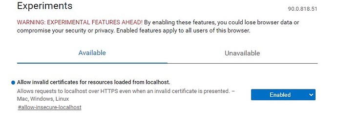

Not really sure what this does but setting by default is disabled.
When I enabled setting Pihole subsequently loaded the dashboard no problem and a couple of tabs that had the error message I posted in initial question all refreshed and loaded dashboard.
