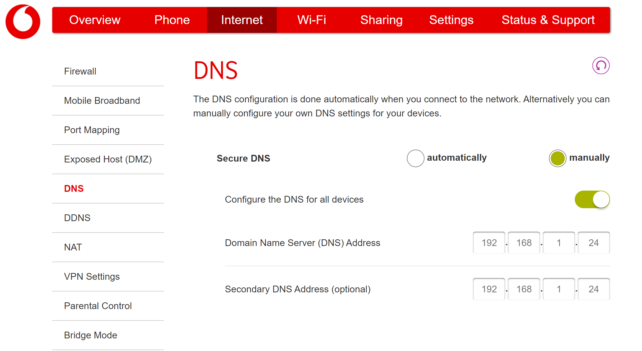

Every time I change the DNS on the router to point at Pi-hole the internet goes dead and I cannot access any sites.

Ok I've turned off wifi, albeit temporarily for the moment.
I've filled each of the two DNS slots with Pi-hole address, however ipconfig/all on the client is showing 3 addresses, one of which is still the router.

Unfortunately I cannot configure the upstream DNS. I can only configure what the router distributes locally, so I can choose automatic or manual.

I can see the upstream Vodafone DNS IPs but cannot change them. Only DNS changes I can make are per the screenshot shared in a post above. When I make changes in that screen the IPs are distributed to the client machines along with the router's own IP.
I do not know your router (or the majority of routers out there), so my advice can only be somewhat generic when it comes to configuring it.
You'd have to figure for yourself if and how your router supports it.
Your screenshot would allow multiple interpretations.
An Internet setting would suggest you are configuring upstream DNS, while the Configure the DNS for all devices option suggests otherwise.
Maybe it's doing both, which would definitely by dodgy, since that would close a DNS loop.
Distribution of a local DNS server via DHCP is commonly a LAN/DHCP setting.
You'd really have to consult your router's documentation sources to be sure. :wink:
Unfortunately Vodafone documentation is poor on this bar a very basic manual.
