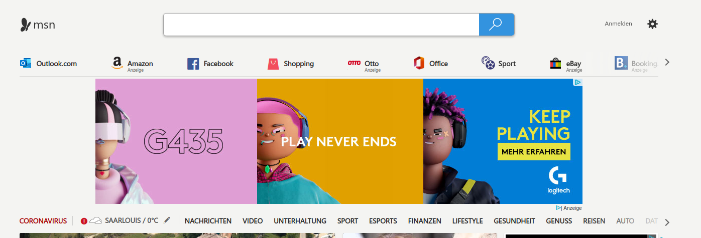

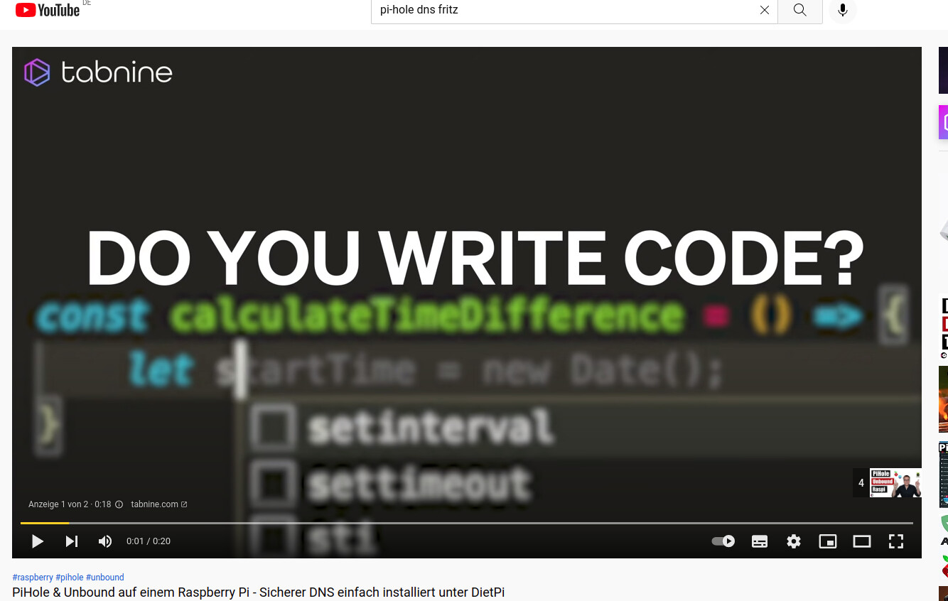

Ads on websites (like msn.com) or youtube (these AD vids in between) are not filtered out.
This suggest a wrong configuration in my network provoking these problems.

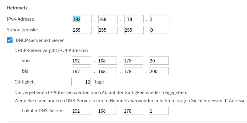

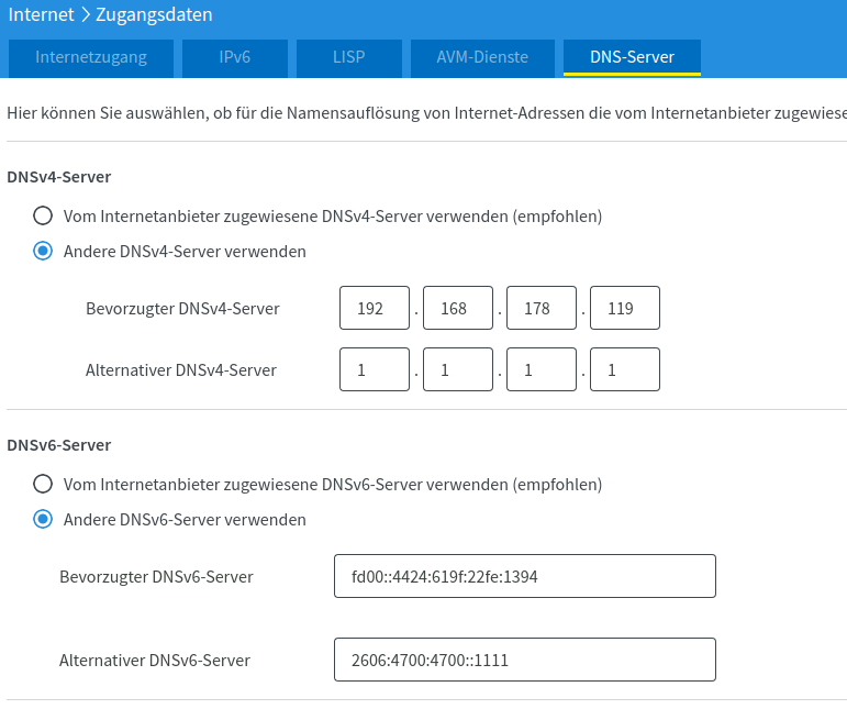

1. Fritzbox configuration:
DNS-Server configuration ( Home network -> network -> ipv4 settings) telling the clients that its still my Fritzbox and nothing changed here:
DNS-Server settings (Internet -> DNS-Server) considering internet-traffic is set up like the following. Here i have set the static IP of the Pi-hole (192.168.178.119) in my network.

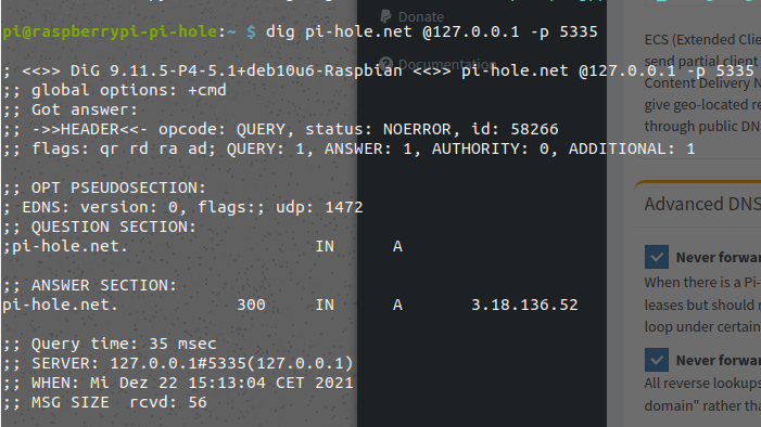

As DNS-settings, i am using unbound and this seems to work pretty well as the following command line shows it:

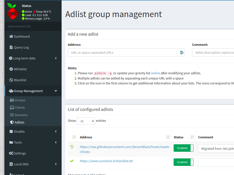

For blocking youtube ads, i have installed under "Adlists" a link copied from sunshine.it. This should help blocking youtube ads (after the description)

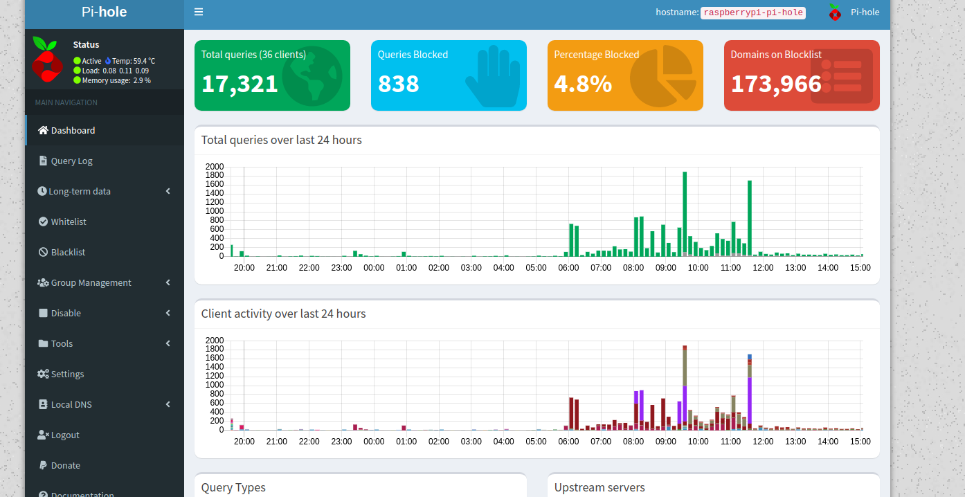

As you can see here, Pi-hole is getting traffic and its shown that queries are blocked and so on...

This is the understanding i have until now: A client request goes first do the fritzbox (192.168.178.1). The fritzbox is redirecting it to the pi-hole (192.168.178.119) which is doing then its job as some DNS settings are set up on Pi-hole.

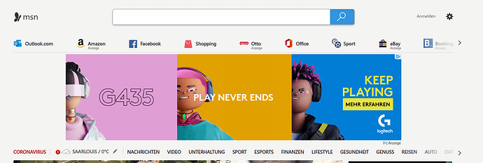

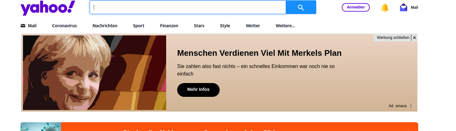

Here some examples of websites not blocking with ads.
MSN
YAHOO

Pi-hole cannot reliably block YouTube ads, since the ads are served from the same domains as the content. If you block the domains, you interfere with the content. There is a long running thread on this topic.
This list won't help much, and will typically interfere with content.
As for the msn.com ads, when I visit that site using Pi-hole only as an ad-blocker (no browser add-ons installed to block ads), I see no ads. I do see sponsored content.

In your specific setup instance, you have provided Cloudflare as a DNS server in addition to Pi-hole. This allows clients to bypass Pi-hole.
