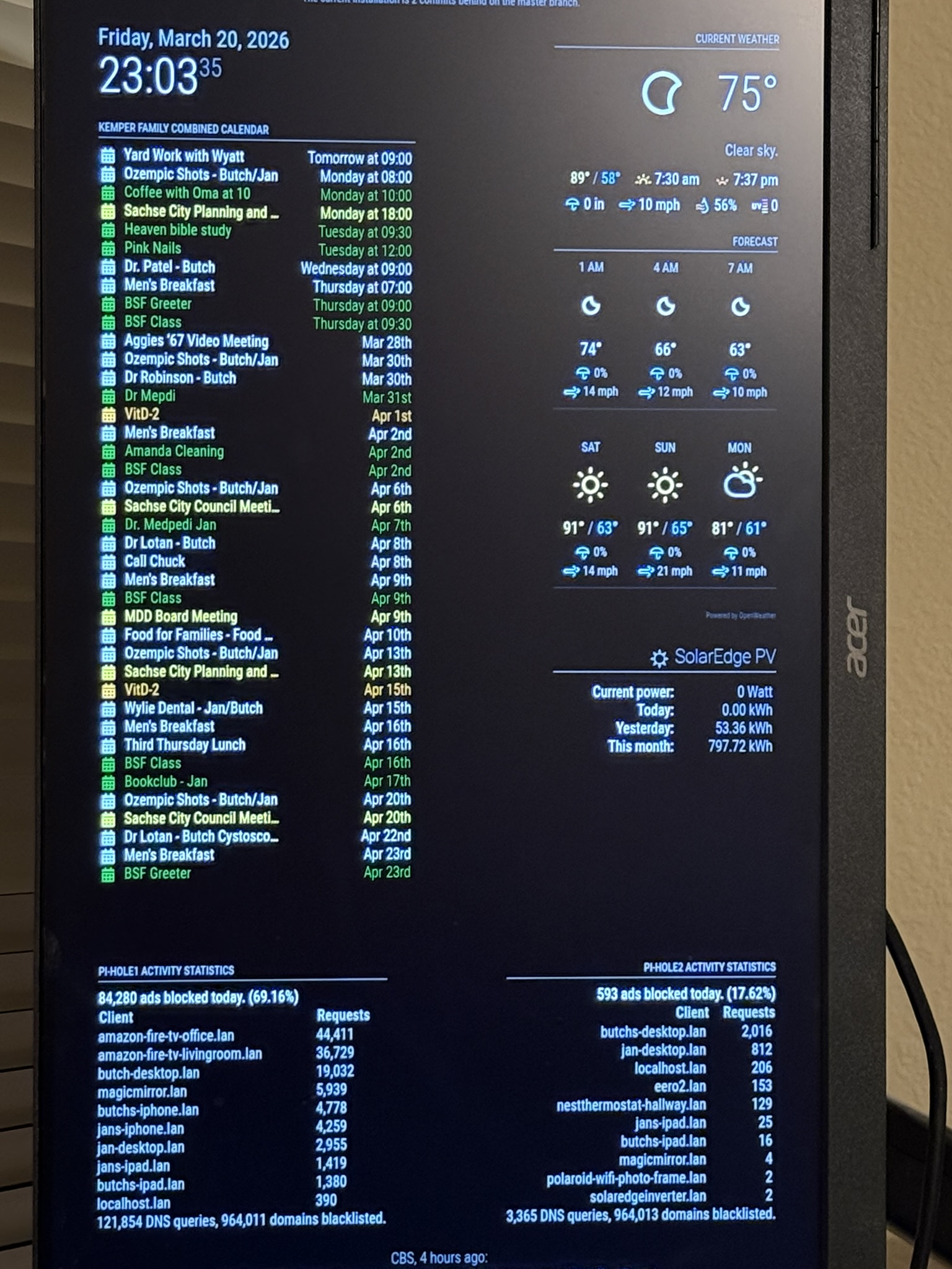

As requested, a picture of the MagicMirror display and the displayed items are:
  • The Calendar display, a combination of four Apple calendars.
  • The Weather display.
  • The Solar Panel System display.
  • The Pi-Hole Statistics displays.
  • The CBS News Headlines.
Again thank you for your help and guidance to find the error.
Butch
