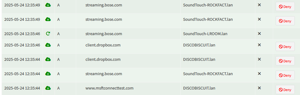

In the pi-hole log, there are still queries coming from the Pc and devices in the house; watching the live feed, they are coming through (Windows, Synology, Microsoft, Firefox...) If I review Tools > Network, I can see both wired and wireless devices with "last query" after the IP address reset.

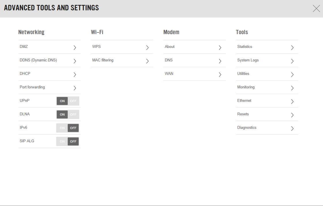

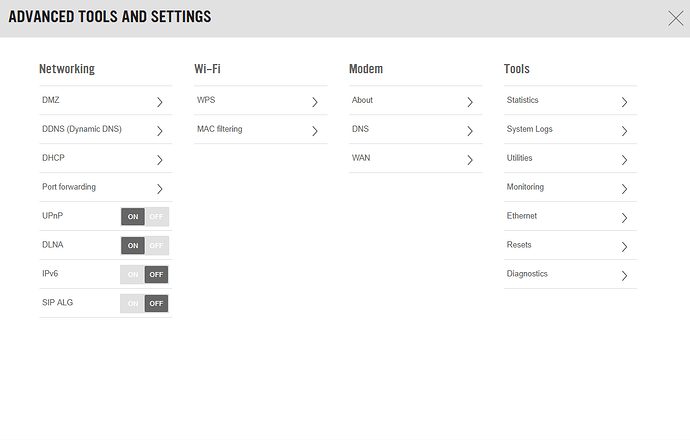

Yes, sorry, I should have mentioned that those IPv6 addresses were via netsh. This router is not great in terms of giving end users much to do under the hood. There's a toggle for IPv6, I'll set it to "off" just to see what happens...
