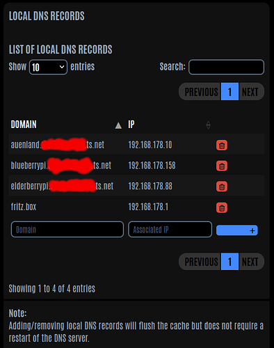

My setup may help you:
elederberrypi(192.168.178.158) and blueberrypi(192.168.178.88) have tailscale installed, Tailscale itself is disabled in my home network.
Both use elederberrypi.my-tailnet.ts.net/blueberrypi.my-tailnet.ts.net tailscale https certificates.
I am also using https://elederberrypi.my-tailnet.ts.net to access them in my home network, due to the signed https certificate.
My local DNS-records:
Thanks for helping!
