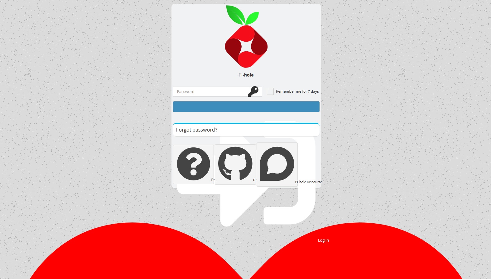

Without an SSL certificate, the website is cleanly displayed in the browser.
We'll set up an SSL certificate (letsencrypt), the icons are very large, and it has been the site of its context, is drawn.
The site seems to be fully working.
What's going wrong here?

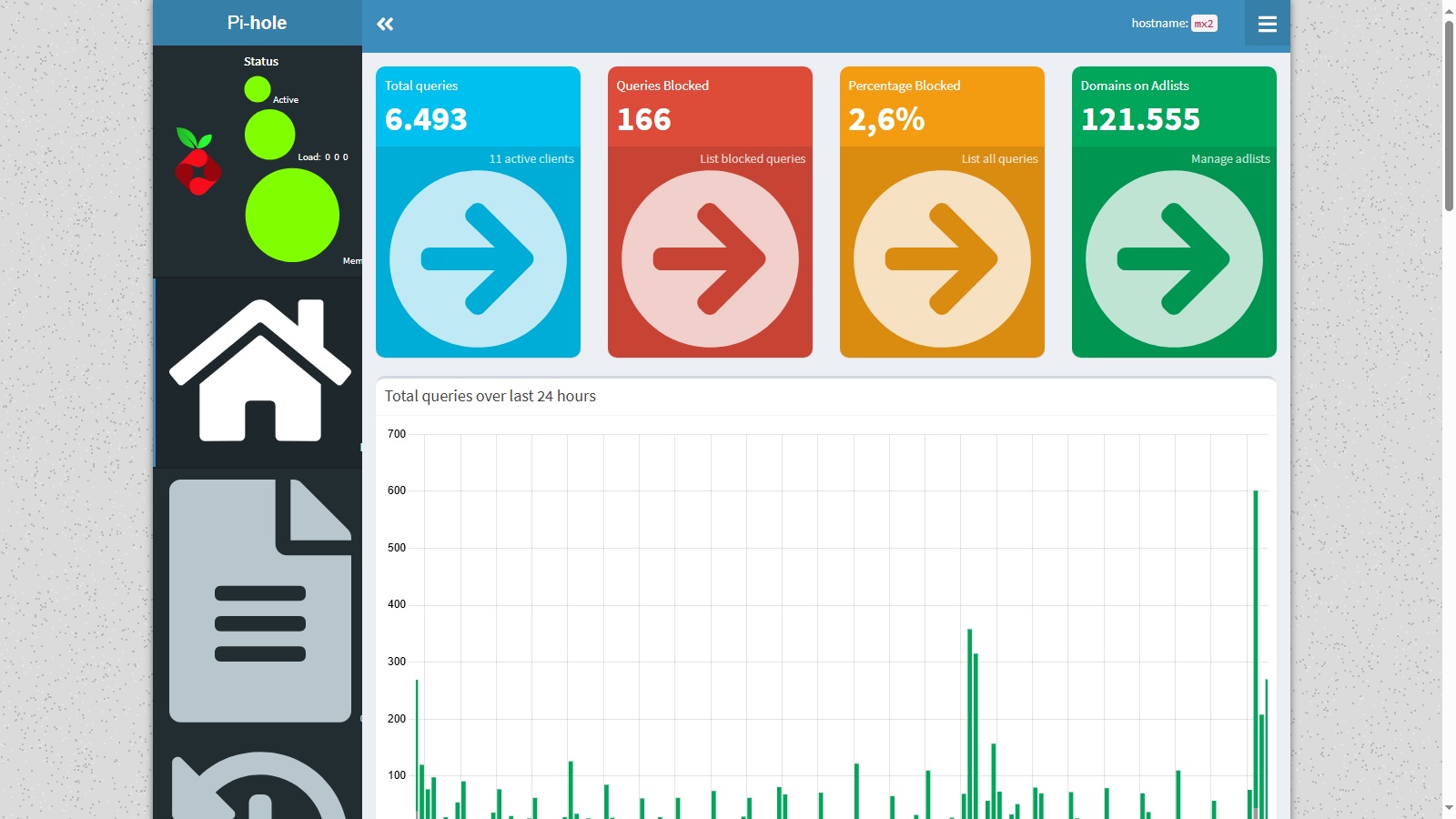

We have implemented this config.
Unfortunately, we are still getting large icons. The ratio of the icons is not correct.
See the attachment.

What's the F12 inspection show? Any assets being blocked?
Looks like the CSS is messed up for some reason.
Exactly like DanSchaper said, your image shows some files are not loaded.
These icons are SVG files. The web interface uses a javascript file (style/vendor/font-awesome/js/all.min.js) to load some CSS rules and format SVG icons. Without these CSS rules the icons are not correctly formatted (size, colors, position, etc.).
Check if nginx configuration is allowing this file to be served.
