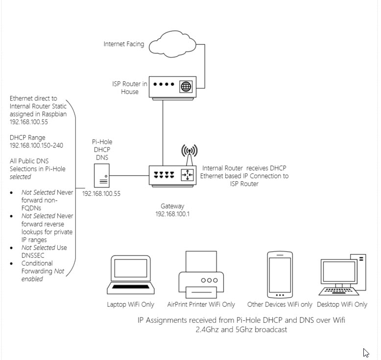

Thanks - I believe I have a networking issue that has been caused by the Pi-Hole being introduced. I apologize for the basic questions, but I am not a networking expert. I have attached a home network diagram, and I had the following questions:
  1. Do I need to have static routes configured anywhere in order for the Pi-Hole DNS to manage full network service broadcast such as Bonjour and most importantly AirPrint
  2. Do I need to address anything in the firewall of the Pi-Hole device in order to unblock #1 .
  3. I know UDP5353 is a Post Airprint relies on being available, but I am not sure where this must be enabled.
  4. Does the Pi-Hole need any form of Static assignments for the above to operate? The gateway, Pi, DNS all have statics
  5. All web outside of wireless printing is working perfectly ( and faster!) so this is the only thing causing an issue
  6. Airprint worked before the Pi-Hole was introduced to the network
Any help would really be appreciated.
Quick point of clarification - the printer is receiving an IP from the Pi-Hole DHCP no problem at all, just like every other device. In addition, in the DNS/DHCP Pi-Hole Admin console I see the Printer registering properly. Same network segment as all other devices.

Now, my next assumption may be a bit of a far call, but I think your network diagram (thank you!) contains a hint to a possible mismatch:
Looking up the specs, it seems your HP 6978 is equipped with built-in WiFi 802.11b/g/n, which means it operates solely on the 2.4GHz band.
Your router, on the other hand, is capable of providing 2.4GHz as well as 5 GHz WiFi. Even if your router is advertising them with the same SSID, this may constitute two separate network segments.
As far as mDNS multicast messages are concerned, this means they would only be visible for devices sharing the same band.
The quickest way to check this would be to disconnect all your WiFi devices, then disable your 5GHz network on your router and reconnect them, effectively forcing all of them to use the 2.4GHz band.
