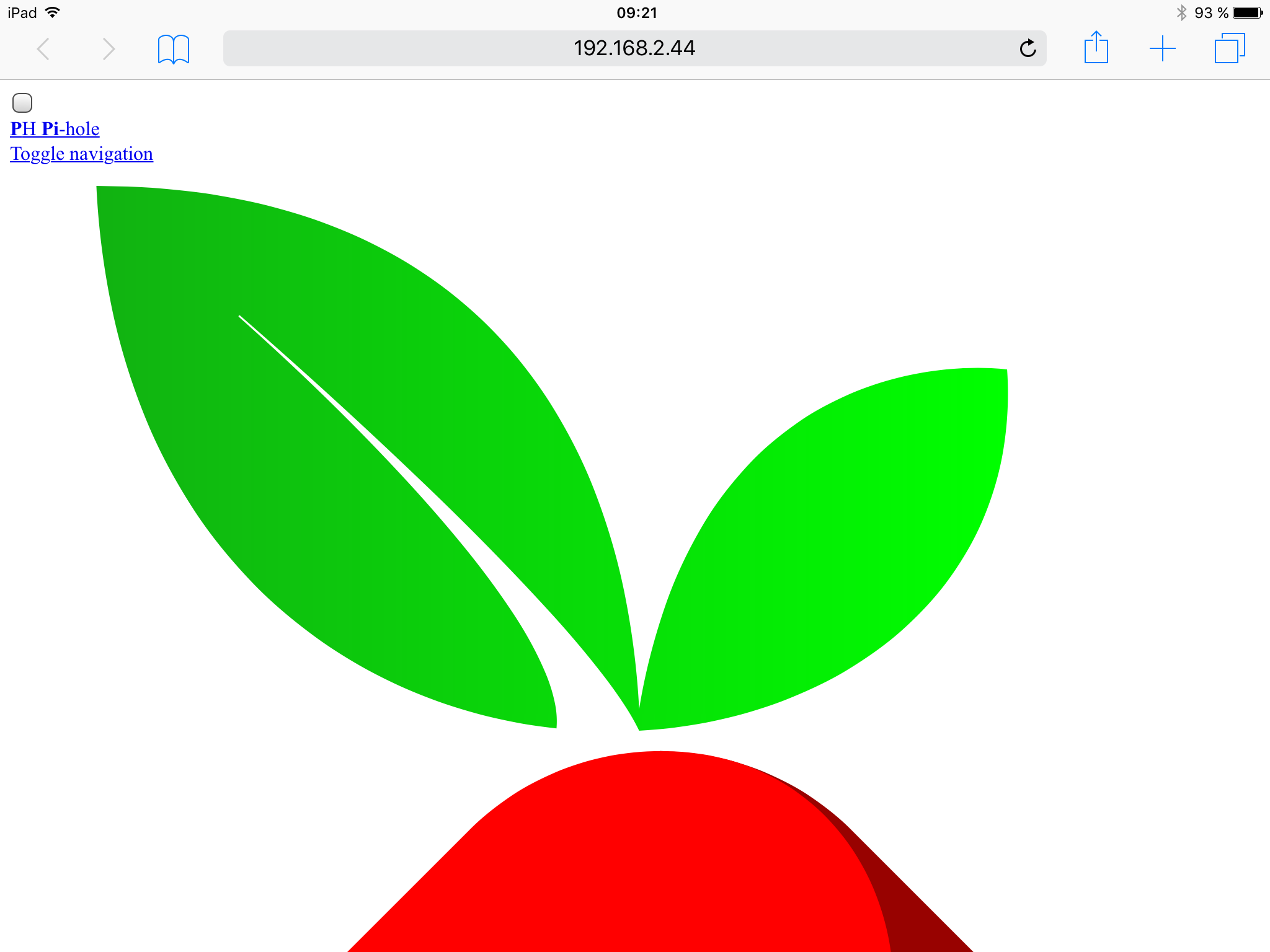

I'm often surfing the web with my iPad (10.2.1). But all I can see when I open the admin page is what the attached screenshots shows.
I have no idea, why. No additional content blocker is activated.
Any ideas from anybody?

But here's the kicker: normally I use FF to surf. But I tried Safari on Mac OS Sierra. And what? The same issue. So my assumption is, that the pi hole admin page html/css/js assets do not play along with apple's webkit.
This is Safaris Console output:
Global Code — footer.js:2 ReferenceError: Can't find variable: $
Global Code — index.js:241 ReferenceError: Can't find variable: $

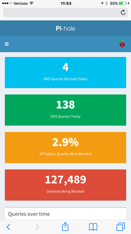

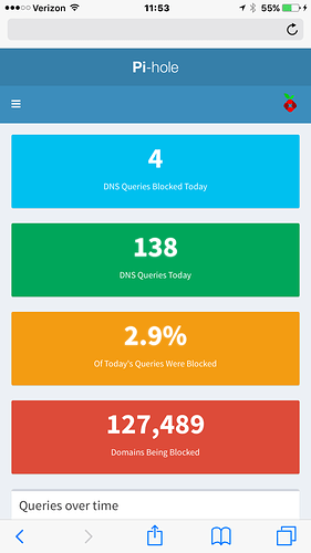

It works fine for me in Safari in both macOS Sierra (10.12.3) and iOS (10.2.1)--both an iPhone and iPad mini.
