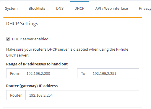

Strange thing is though, it is in /etc/pihole/dhcp.leases:
1592592132 dc:a6:32:77:31:83 192.168.2.229 raspberrypi 01:dc:a6:32:77:31:83
Further everything is working fine.
Details about my system:
Pi-hole is configured as DHCP. The router's DHCP is off.

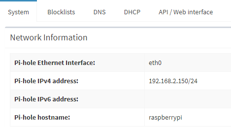

Here are a couple of screenshots:

Nut sure if going to fix but you could try change hostname for the Pi-hole host into that FQDN one "raspberrypi.home" with below:
sudo hostnamectl set-hostname raspberrypi.home
Edit the /etc/hosts file and change that one line into below:
127.0.1.1 raspberrypi.home raspberrypi
And run reconfigure to tell Pi-hole of the hostname change:
pihole -r
And check afterwards again on that Win client with nslookup.
