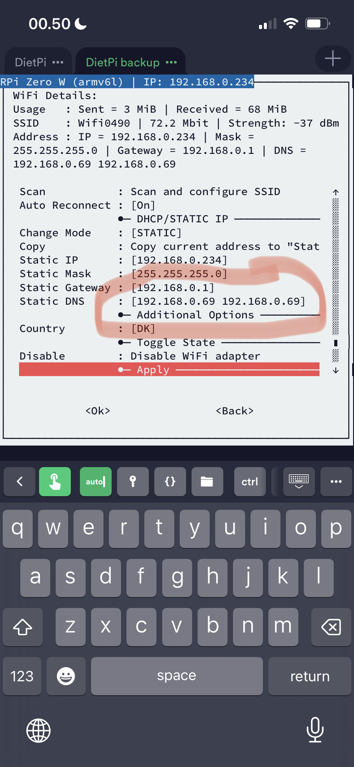

**The issue I am facing:I don’t know whether to configure my Pi-holes as the DNS on my router only, or also directly in the config of my Pi’s
**Details about my system:I have a Zero W and a Pi 3b running Dietpi and Pi-hole. They act as my primary and secondary DNS.
**What I have changed since installing Pi-hole:Only
installed Unbound
