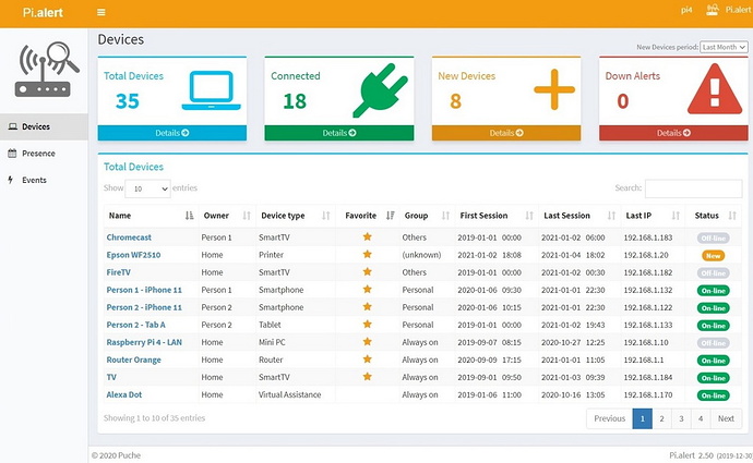

I have created this complementary application to Pi-hole, that I think may be of interest to you.
https://github.com/pucherot/Pi.Alert
Pi.Alert
WIFI / LAN intruder detector.
Scan the devices connected to your WIFI / LAN and alert you the connection of
unknown devices. It also warns the disconnection of "always connected" devices.
How it works
The system continuously scans the network for:
  • New devices
  • New connections (re-connections)
  • Disconnections
  • "Always Connected" devices down
  • Devices IP changes
  • Internet IP address changes
Scan Methods
Up to three scanning methods are used:
  • Method 1: arp-scan. The arp-scan system utility is used to search
    for devices on the network using arp frames.
  • Method 2: Pi-hole. This method is optional and complementary to
    method 1. If the Pi-hole DNS server is active, Pi.Alert examines its
    activity looking for active devices using DNS that have not been
    detected by method 1.
  • Method 3. dnsmasq. This method is optional and complementary to the
    previous methods. If the DHCP server dnsmasq is active, Pi.Alert
    examines the DHCP leases (addresses assigned) to find active devices
    that were not discovered by the other methods.
More info here: https://github.com/pucherot/Pi.Alert
Thank you very much
What do you think about this application?
