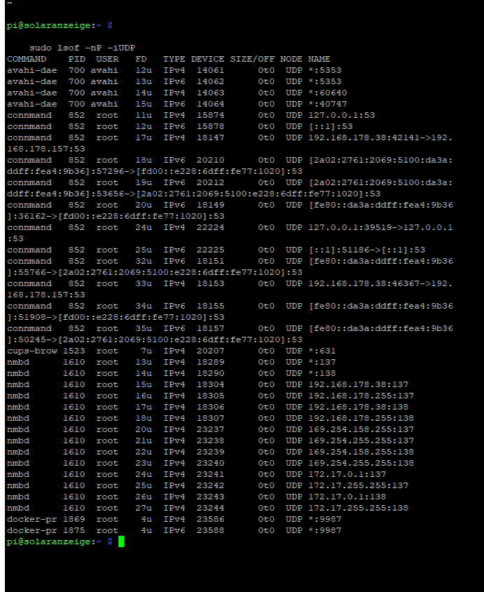

There is still a service thats keeping that connman service on port 53. I'm trying to figure that out at the moment.

reboot and check the ports with:

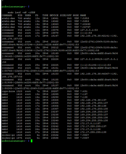

sudo lsof -nP -iUDP
Hi in the solar display forum, I already wrote that unfortunately no one knows why this is the case.
I would give the arch.wiki instructions a shot then. Create the directory and file and see if that helps. If not I'm not sure what else to try.
Thank you, I've already tried it, unfortunately it doesn't work either. Have you tried installing the solar display image?
