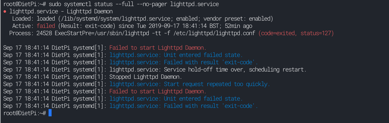

What is the message from sudo systemctl status --full --no-pager lighttpd.service?
Hold on , almost the same :wink:
Could be config files.
This time though it doesn't appear to be a library issue.
Try manually running sudo /usr/sbin/lighttpd -tt -f /etc/lighttpd/lighttpd.conf and check for the error output.
/usr/sbin/lighttpd: symbol lookup error: /usr/lib/arm-linux-gnueabihf/libcrypto.so.1.1: undefined symbol: VAL_CTX_new, version OPENSSL_1_1_0
