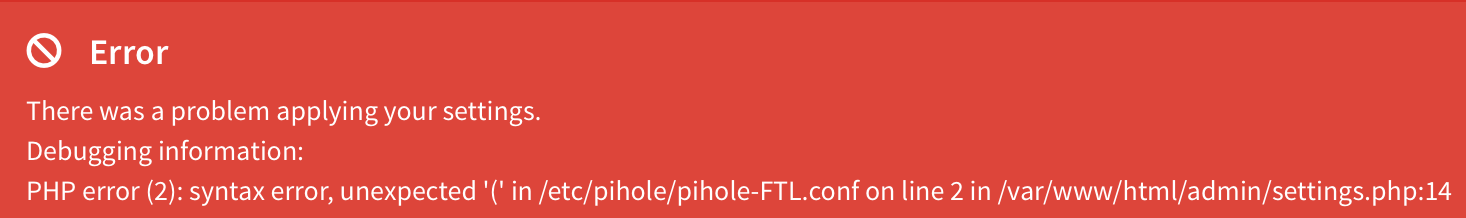

Problem with Beta 5.0:
Error
There was a problem applying your settings.
Debugging information:
PHP error (2): syntax error, unexpected '(' in /etc/pihole/pihole-FTL.conf on line 2 in /var/www/html/admin/settings.php:14
I played around applying recommendations from this post .. not sure what created an issue but can't find what the error says ...

Let's look at this file. What is the output of cat etc/pihole/pihole-FTL.conf
I put comments to ignore what I had added:
BLOCKINGMODE=IP-NODATA-AAAA
#Make FTL only analyze A and AAAA queries (true or false)
#ANALYZE_ONLY_A_AND_AAAA=true
#TTL (90-days) entries for FTL database (saves on space)
#MAXDBDAYS=90
PRIVACYLEVEL=0
Remove the lines with the comments; or specifically the line with the ( included; save the file and restart FTL with sudo service pihole-FTL restart. See if the problem resolves.
Bingo! Fixed ... I'll leave it at that.

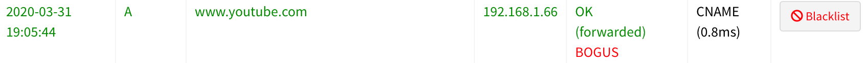

By the way, I am using unbound and if I check "use dnssec" in pihole youtube doesn't load anymore. Seen as BOGUS. Is this normal? Should I just uncheck DNSSEC in pihole and use the one included in unbound?
This is correct. Unbound is already doing DNSSEC if you set it up per the Pi-hole guide (and likely by default anyway).

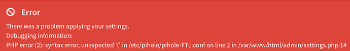

If you want to use the special characters in comments us ; instead of #.
The reason is that `pihole-FTL.conf``is treated by php as an ini file and comment lines have to begin with a semicolon.
But as jfb said: removing the special characters is always a good idea :wink:
Just pointing out that FTL itself is great in recognizing comments, it will even recognize if you just start text even without explicitly marking it as a comment. Whatever does not follow the PROPERTY=VALUE format is ignored.
This to avoid failures of the DNS service because of a messed up config file.
Why am I not surprised that your FTL code is more robust than a standard php function?!
