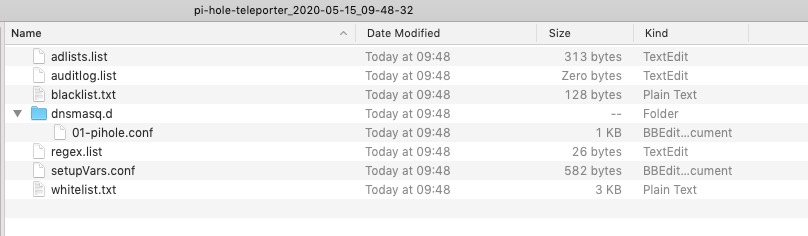

With a few caveats. Pi-hole V4 teleporter may not export your custom configurations, like /etc/hosts, and it does not export /etc/pihole/pihole-FTL.conf, for example. These you will need to copy manually.
Here is what is exported (I don't use Pi-hole as DHCP, so none of those files are in my export):
