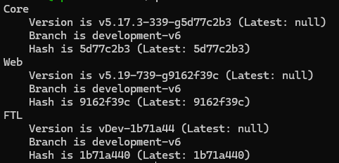

  • Core vDev (development-v6, 5d77c2b3)
  • FTL vDev (development-v6, 1b71a440)
  • Web interface vDev (development-v6, 9162f39c)

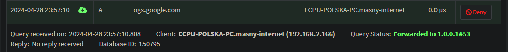

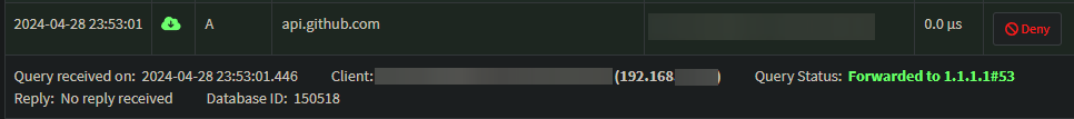

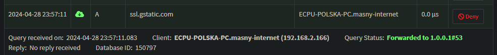

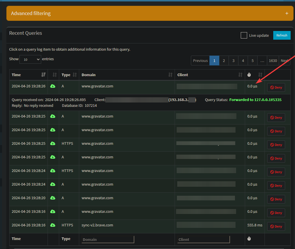

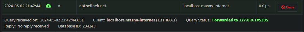

Without a proper Debug Log, we only have your screenshots information.
Your screenshot shows Pi-hole forwarded the query to Unbound: image
But Unbound never answered: image
You need to find out why unbound is not answering.

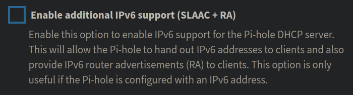

Simply disable this check box:
Do you see similar issues as the ones pointed out by @rdwebdesign ? Queries being forwarded but no replies ever arriving? It may point to an interface or routing issue on your device that we can try to debug together.
No, this is a simple misunderstanding: The DHCP server cannot serve itself with an address. The DHCP server itself always needs a static address - which is what you have done and it immediately started working as expected.
This checkbox is unchecked. Despite this, Pi-hole still serves IPv6 to every device on the network. If any DNS query goes through IPv6, Pi-hole completely ignores it.

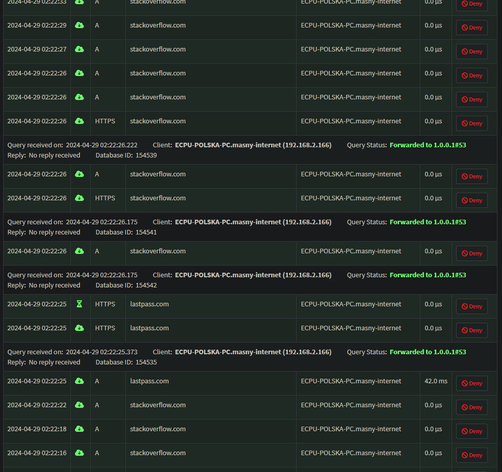

As for Unbound, I have now changed the DNS settings to 1.1.1.1 & 1.0.0.1 in pihole for tests
Thanks for your reply
UPDATE: I have the same issue with 1.1.1.1 & 1.0.0.1.

If the box is uncheched, Pi-hole won't do anything concerning IPv6 addresses. It is likely your Internet router that is still managing IPv6 and - not knowing anything about Pi-hole - it serves IPv6 configuration that is problematic in your case.

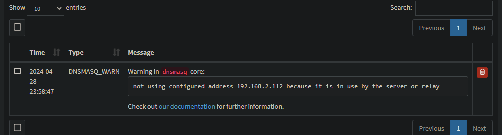

Your debug log reveals a few strange issues:
  • You are receiving DHCP data from three servers:
    • 169.254.248.190 (your Pi-hole) <---- this address shouldn't be there
    • 192.168.2.112 (your Pi-hole)
    • 192.168.2.186 (something else)
  • There is also a warning about address conflicts in your Pihole diagnosis messages:
    Not using configured address 192.168.2.112 because it is in use by the server or relay
    (you have seen this already)

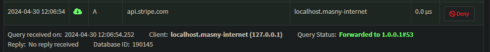

DHCP is not the problem, nor is my router. I had the same issue on my previous Huawei B525 router, even when I wasn't using DHCP from Pi-hole. Just now, the DNS got clogged up again, and I lost a potential client because my server couldn't establish a connection with Stripe and threw a 500 error on the site. Really thanks :smile:
12:06:59.260 30.04.2024: [Subscription]: StripeConnectionError: An error occurred with our connection to Stripe. Request was retried 1 times.
12:06:59.261 30.04.2024:     at XXXX/node_modules/stripe/cjs/RequestSender.js:326:37
12:06:59.261 30.04.2024:     at process.processTicksAndRejections (node:internal/process/task_queues:95:5) {
12:06:59.261 30.04.2024:   type: 'StripeConnectionError',
12:06:59.261 30.04.2024:   raw: {
12:06:59.261 30.04.2024:     message: 'An error occurred with our connection to Stripe. Request was retried 1 times.',
12:06:59.261 30.04.2024:     detail: Error: getaddrinfo EAI_AGAIN api.stripe.com
12:06:59.261 30.04.2024:         at GetAddrInfoReqWrap.onlookupall [as oncomplete] (node:dns:118:26) {
12:06:59.261 30.04.2024:       errno: -3001,
12:06:59.261 30.04.2024:       code: 'EAI_AGAIN',
12:06:59.261 30.04.2024:       syscall: 'getaddrinfo',
12:06:59.261 30.04.2024:       hostname: 'api.stripe.com'
12:06:59.261 30.04.2024:     }
12:06:59.261 30.04.2024:   },
12:06:59.261 30.04.2024:   rawType: undefined,
12:06:59.261 30.04.2024:   code: undefined,
12:06:59.261 30.04.2024:   doc_url: undefined,
12:06:59.261 30.04.2024:   param: undefined,
12:06:59.262 30.04.2024:       at GetAddrInfoReqWrap.onlookupall [as oncomplete] (node:dns:118:26) {
12:06:59.262 30.04.2024:     errno: -3001,
12:06:59.262 30.04.2024:     code: 'EAI_AGAIN',
12:06:59.262 30.04.2024:     syscall: 'getaddrinfo',
12:06:59.262 30.04.2024:     hostname: 'api.stripe.com'
12:06:59.262 30.04.2024:   },
12:06:59.262 30.04.2024:   headers: undefined,
12:06:59.262 30.04.2024:   requestId: undefined,
12:06:59.262 30.04.2024:   statusCode: undefined,
12:06:59.262 30.04.2024:   charge: undefined,
12:06:59.262 30.04.2024:   decline_code: undefined,
12:06:59.262 30.04.2024:   payment_intent: undefined,
12:06:59.262 30.04.2024:   payment_method: undefined,
12:06:59.262 30.04.2024:   payment_method_type: undefined,
12:06:59.262 30.04.2024:   setup_intent: undefined,
12:06:59.262 30.04.2024:   source: undefined
12:06:59.262 30.04.2024: }```
Okay, so what is the problem?

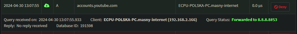

A DNS failure just occurred with Pi-hole. I executed the command dig api.sefinek.net @127.0.0.1 and my site's IP was not resolved at all. When I executed dig api.sefinek.net @8.8.8.8, I received the result immediately.
It appears the fault lies with Pi-hole. Please fix it.
sefinek@hp-terminal1:~$ sudo cat /var/log/pihole/FTL.log
2024-05-02 02:44:21.096 [83121/T149324] INFO: Optimized database in 0.035 seconds
/var/log/pihole/pihole.log
May  2 21:42:44 dnsmasq[83121]: query[A] api.sefinek.net from 127.0.0.1
May  2 21:42:44 dnsmasq[83121]: forwarded api.sefinek.net to 127.0.0.1#5335
May  2 21:42:49 dnsmasq[83121]: query[A] api.sefinek.net from 127.0.0.1
May  2 21:42:49 dnsmasq[83121]: forwarded api.sefinek.net to 127.0.0.1#5335
May  2 21:42:59 dnsmasq[83121]: query[A] api.sefinek.net from 127.0.0.1
May  2 21:42:59 dnsmasq[83121]: forwarded api.sefinek.net to 127.0.0.1#5335
May  2 21:43:03 dnsmasq[83121]: reply api.sefinek.net is 188.114.97.4
May  2 21:43:03 dnsmasq[83121]: reply api.sefinek.net is 188.114.96.4
This log you posted shows that the error is within your local unbound not replying for some time. Please enable logging in unbound and also show its logs as we will need to fix the error here.
