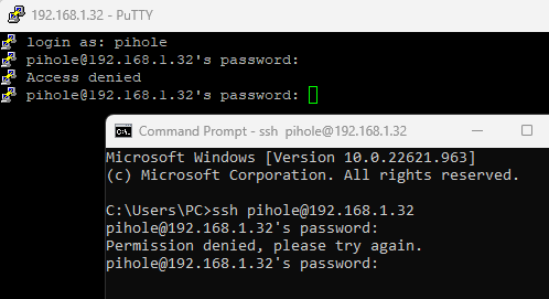

I'm getting the error message Permission denied, please try again (CMD) & Access denied (PuTTY) when prompted to enter password when trying to ssh into my pi(s). The issue happens on both raspberry my pi's. I've also tried using two SD cards.

Your screenshot simply suggests that you are not supplying the correct credentials to login.
Use the correct credentials as set in Raspberry Pi imager during sd card preparation.

I understand that, however; I've used the password I created via the imager and the default "raspberry" password and they're not working. There must be a workaround to setup a new password or get access in this situations.
  • Am I using the correct raspberry default for pi OS lite?
  • Is there a way to wipe the password & create a new one?
Writing the image afresh would be the easiest approach.
There may be ways to reconfigure ssh, but only if you can access your RPi via other means than ssh, e.g. if you have a keyboard and a screen attached to it.
As this isn't a Pi-hole issue, you also may want to consider consulting other forums specialising in RPis for a solution.
You could try attaching a keyboard and HDMI display (eg TV) and booting it and seeing if it takes you to a logged-in terminal. If so then you can change your password with the passwd command. However if not then yes a reimage is probably easiest. You can set the username as pi and select a password and enable ssh directly in the Pi Imager software when you write the image, by clicking the cogwheel icon in the bottom right after selecting your image.

Ran into this exact issue myself. Turned out, I didn't change the default user name when I ran the wizard, so I had to ssh like this: ssh pi@pihole
Then enter the password.
That would match my initial recommendation:
For Jbop, that would mean that ssh pi@192.168.1.32 may be worth a try. :wink:
There you go. Forgot I was on Linux and on the same network.
