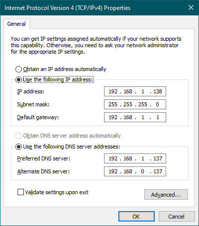

I have my windows pc ip set manually like so
net
I don't know how the windows PC is connecting with routers DHCP disabled and RPI disconnected.
That is odd, so I pointed manual dns to pi hole ip. but with routers dhcp disabled, and was pointed at 192.168.1.1, this PC should have not have any connection, because dhcp is being handled by pi hole and it was shutdown, but was able to still browse with manual dns set to routers ip 192.168.1.1 with routers dhcp disabled.

Manual set Set on 192.168.1.137
DNS Servers . . . . . . . . . . . : 192.168.1.137
                                       192.168.0.137
                                       192.168.0.1

Windows PC was set to 192.168.1.1 DNS which originally when I had the RPI just have RPI OS and PI Hole in which the router DNS was directed to PI Hole IP address. That's why I am confused my DHCP is disabled on the router and PI Hole is DHCP and the windows PC still had connection with internet while RPI was shut off with 192.168.1.1 as network adapter windows 10 manual DNS set..
The 192.168.1.137 is RPI/PI-Hole/Unbound.

So on the manual edit on windows 10 network adapter I have set dns1 and 2 as is doubled with DNS ip, same in both fields 1 and 2, windows is set but shows 192.168.0.1 and 192.168.0.13.
network
                                       192.168.0.137
