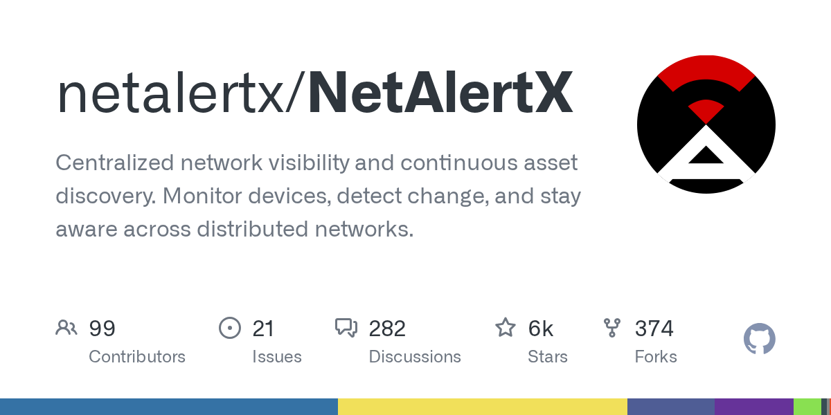

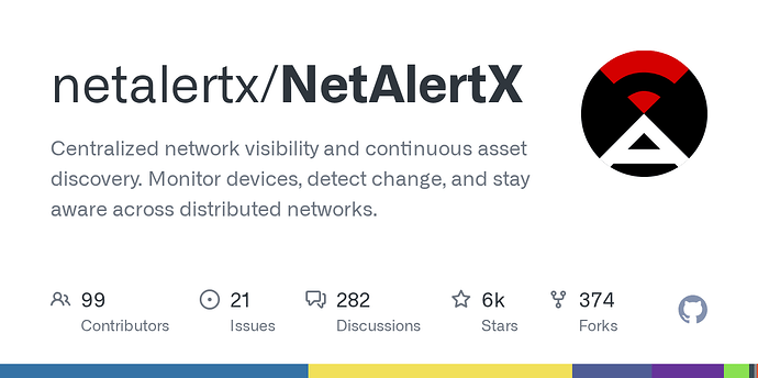

If you want more information about devices on your network you might want to take a look at netalertX
