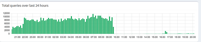

  2. Total queries is massive - 500,000 in a day or so. Blocked queries is essentially nothing: https://imgur.com/a/E7FO33C

Just checked my graph and you can see where I switched from the unbound DNS server to quad 9 this morning!
