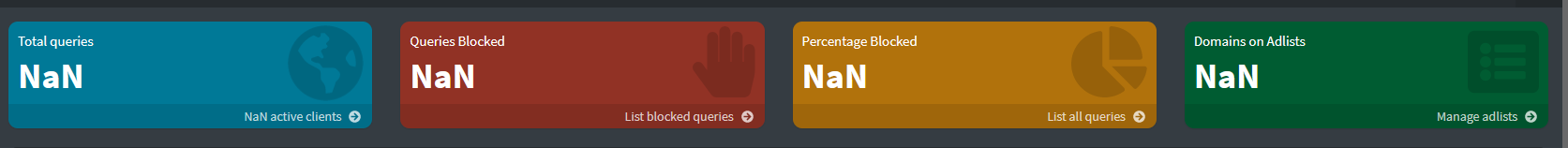

This morning my Proxmox server warned me, that the disk is full and Pi-Hole said over 2GB in log files.
Pi-Hole couldn't load the web GUI properly but i saw 40 million queries.
WTF?! Thats 55k per minute for approx. 6 hours, twice as much as a whole day
I couldn't see any entries because nothing was working until i deleted the log file.

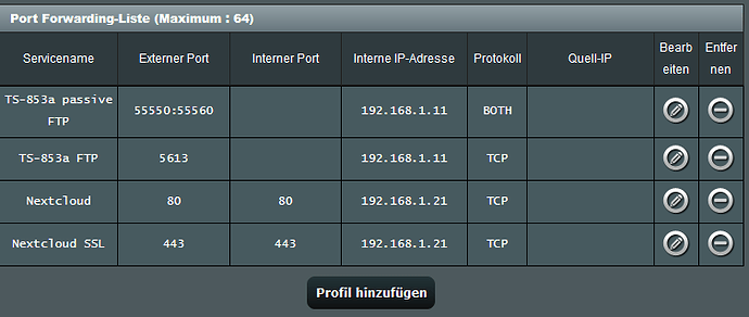

Though from the sounds of things you have port 53 open to the outside world. If so, close it immediately - it is dangerous to run an open resolver
pihole_debug.zip (9.8 KB)

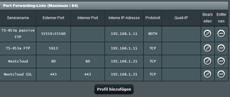

Here you go. And no, 53 is not accesible. Only 80,443,5613 and passive FTP ports. And all these are forwarded to my NAS and not the Proxmox-Server (Pi-Hole especially)
But please correct me if I'm wrong.
OK, glad it is not public - but had to make sure first!

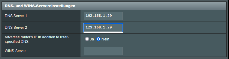

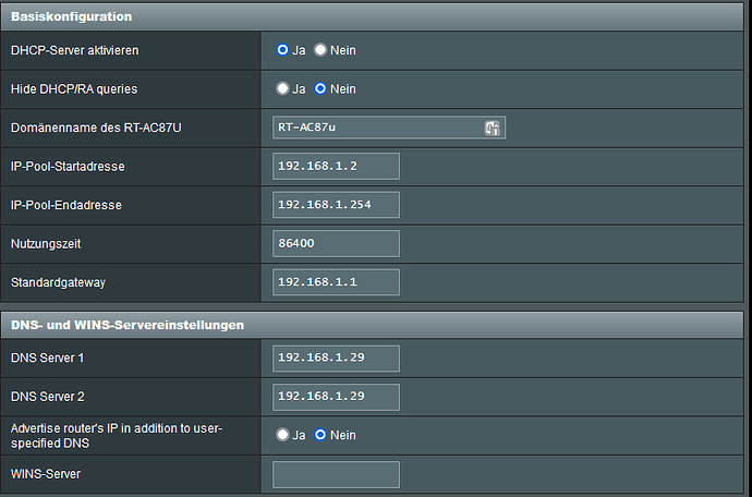

Hm... my router is 192.168.1.1 and its DNS is both (1st and 2nd) 192.168.1.29 (Pi-Hole)
So my clients are routed to my router and from there to Pi-Hole.
The router is my DHCP server with several static IPs and the rest dynamic.

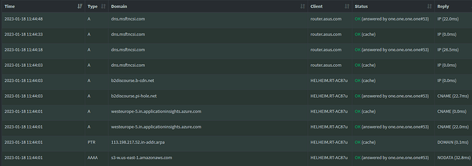

FYI: all the dns.msftncsi.com are single requests from the ASUS router. I will deactivate this later. It's not a loop.
Right now after 5 hours of operation, Pi-Hole has recorded 13.602 queries. After 24 hours it should be somewhere around 65.000. But not 40 Million over night.

No, your clients are talking to directly to PI-hole for DNS, as your router's DHCP server is telling them to:
*** [ DIAGNOSING ]:e[0m Discovering active DHCP servers (takes 10 seconds)
   * Received 315 bytes from eth0:192.168.1.1
     Offered IP address: 192.168.1.29
     DHCP options:
      Message type: DHCPOFFER (2)
      dns-server: 192.168.1.29
      router: 192.168.1.1
      --- end of options ---

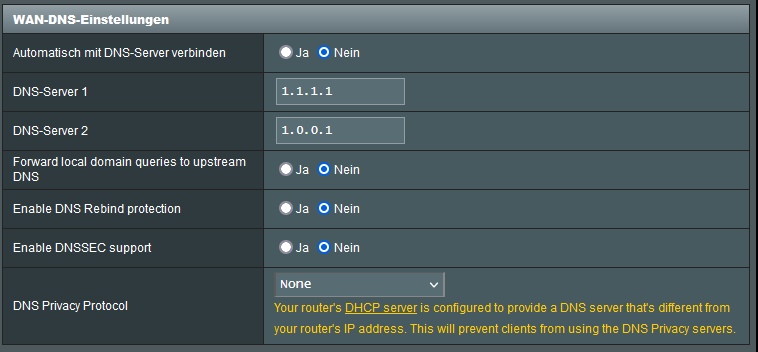

PromoFaux asked about the DNS server that your router itself is using as upstream DNS. Commonly, that is a WAN/Internet setting in your router.
Conditional Forwarding may cause a partial loop if your router would be using Pi-hole as its upstream.
If that would be the case, you should be able to trigger it by requesting resolution of a non-existent local hostname, e.g. nslookup bogus-hostname. If that request would be looping, it would become rate-limited by Pi-hole (if you'd reverted your Pi-hole's rate-limit setting), and it should show up in Pi-hole's diagnosis pane as well.
Let me try the nslookup when I'm back home.
The router is using Pi-Hole as DNS but the upstream (Gateway) comes from my ISP.
Let's say my current WAN IP is 1.2.3.100, then the gateway is 1.2.3.254. That's something I can't edit.
That could well be the case, but you may want verify that via your router.

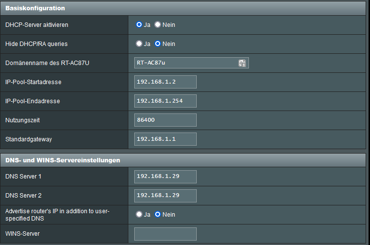

The screenshot you've shared above quite likely shows your router's DHCP server DNS configuration, as the information (double .129) nicely aligns with your DHCP server's response I've quoted above from your debug log.
I'd expect the DNS servers that your router itself would be using to be shown on a different screen, commonly a WAN/Internet setting.

I can only see the ISP's gateway in LAN/WAN settings and the DHCP DNS.
LAN gateway is my router: 192.168.1.1 (changeable)
DNS is 192.168.1.29 (Pi-Hole, changeable)
Upstream Link is 31.xx.xx.254 (gateway from ISP and not changeable by me)
WAN IP is 31.xx.xx.146 (provided by ISP, non static and not changeable)
Right now im a little bit confused. The requests go to Pi-Hole and Pi-Hole itself uses Cloudflare.
Even the router is using Pi-Hole (seen in the log files) and therefore everything goes via Cloudflare.

My file is over 2GB again and Pi-Hole says:
There was a problem applying your settings.
Debugging information:
PHP error (2): fsockopen(): Unable to connect to 127.0.0.1:4711 (Connection refused) in /var/www/html/admin/scripts/pi-hole/php/FTL.php:47
and the GUI:
But its interesting. That was a random hit. I haven't done anything. I was eating and returned to my PC.

To address this, you should consider to remove Pi-hole from your router's upstream DNS server configuration.
So I found the settings.
WAN-DNS is now 1.1.1.1 / 1.0.0.1
DHCP DNS is 192.168.1.29 / 192.168.1.29
That should work, shouldn't it?
and DHCP:
And the device is my fucking business iPhone (controlled by my company).
